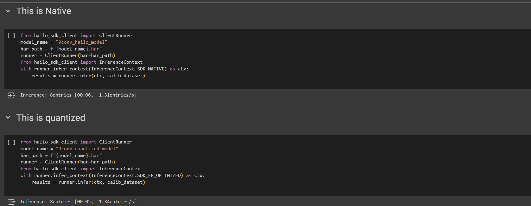

its right on the google colab where after you conver can you see this code
this is how you infer the .har hailo model format

and i think i forgot to dequantize right @omria not sure is there any operator for dequantizing the output
@omria @SAN

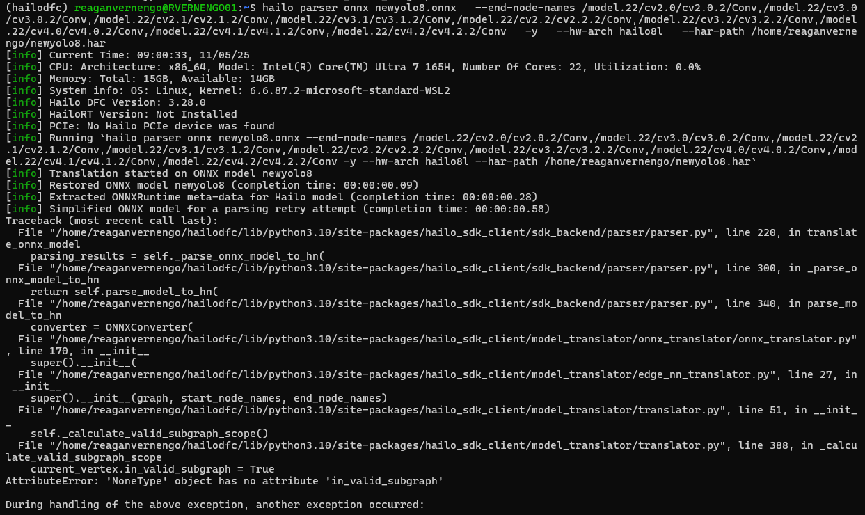

I tried to parse through using the correct end nodes, and I still get this error. Is my syntax incorrect?
im not sure about this error but i believe,
The ONNX model might have unsupported layers or structure, or specified end-node names may not match the actual graph nodes. Could you recheck using netron Model visualizer
