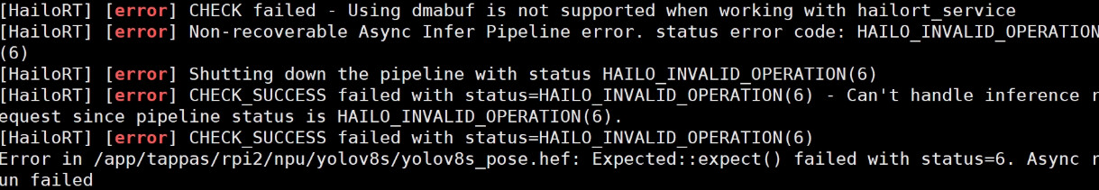

I am trying to optimize my inference pipeline by using DMA-BUF for zero-copy memory access. However, when I try to run it, I encounter an error (HAILO_INVALID_OPERATION(6)) stating that using dmabuf is not supported when working with MPS (hailort_service).

Short answer to both questions: yes, they are different things, and yes, the limitation is by design — but it is a transport limitation, and it does not always trigger. I spent some time on this with HailoRT 4.23.0 and a Hailo-8L, so let me share what I found.
The shared memory used by MPS is POSIX shared memory. What crosses the RPC channel is a name, not a descriptor: the service opens it with BufferStorageParams::open_shared_memory(<name>) (hailort_service/hailort_rpc_service.cpp:607) and the transport is gRPC. On the client side there is an explicit memcpy in both directions (network_group_client.cpp:572-614). So MPS shares memory between host processes, and your buffer still gets copied once per direction.
DMA-BUF is a different mechanism. The fd is imported by the driver (vdma_buffer_map_dmabuf, then the HAILO_VDMA_BUFFER_MAP ioctl), so the vDMA reads your pages directly. An fd only means something inside the process that opened it — to pass it to another process you need SCM_RIGHTS over a unix socket, and gRPC does not do that. On top of that, HAILORT_SERVICE_ADDRESS lets the service run on another machine, where an fd makes no sense at all. That is where your error comes from: the check is at service/network_group_client.cpp:601 and it wants BufferType::VIEW. It sits before the shared-memory branch, so turning shared memory off with HAILO_SERVICE_SHARED_MEMORY_OFF does not help either. It is still there in 4.23, and the newer RPC stack refuses it too (“DMA_BUFFER is not supported in HRPC”), so it does not look like an oversight.
Now the part I did not expect. The error is not universal, it depends on your pipeline. Passing a dmabuf as input under MPS, HEFs with on-chip NMS (yolov8n, yolov11n from the zoo) went through fine, while HEFs with raw output tensors (a depth model, an OBB model) failed with exactly your HAILO_INVALID_OPERATION(6). That happens because the buffer reaches the hw element as DMA_BUFFER unless some element calls as_view() first, which mmaps the dmabuf (pipeline.cpp:293). So when it does work under MPS, your dmabuf was already mmapped and copied and you do not get zero-copy anyway. Your yolov8s_pose HEF most likely returns raw tensors, which puts it in the failing group ..
