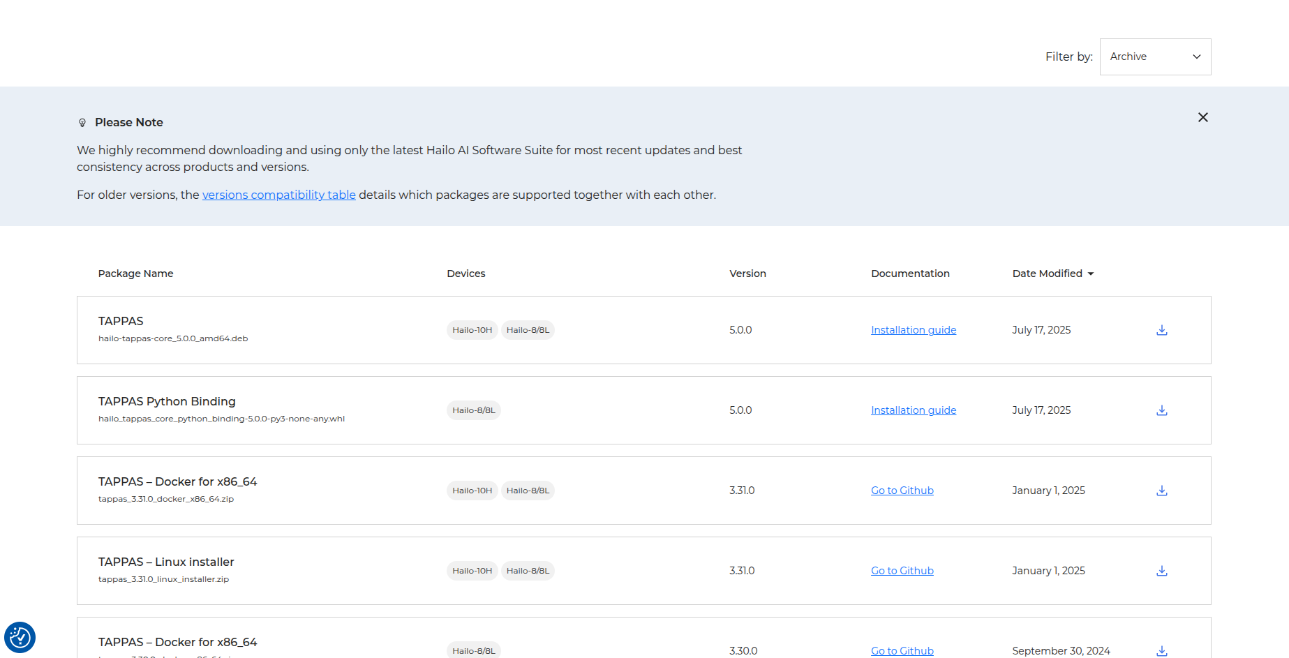

In hailo SKD version 4.22, TAPPAS V5.0.0 can be installed on Raspberry Pi and used, but on the hailo software Downloads page, there is only TAPPASV5.1, so I can't use it. Is there another way?
In hailo SKD version 4.22, TAPPAS V5.0.0 can be installed on Raspberry Pi and used, but on the hailo software Downloads page, there is only TAPPASV5.1, so I can’t use it. Is there another way?
Hey @user325,
You can find it in the developer zone in the , just have to filter for archive :

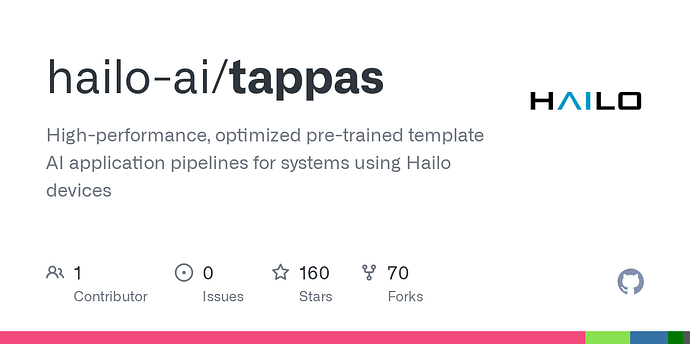

You can also compile it from sources using this repo :
