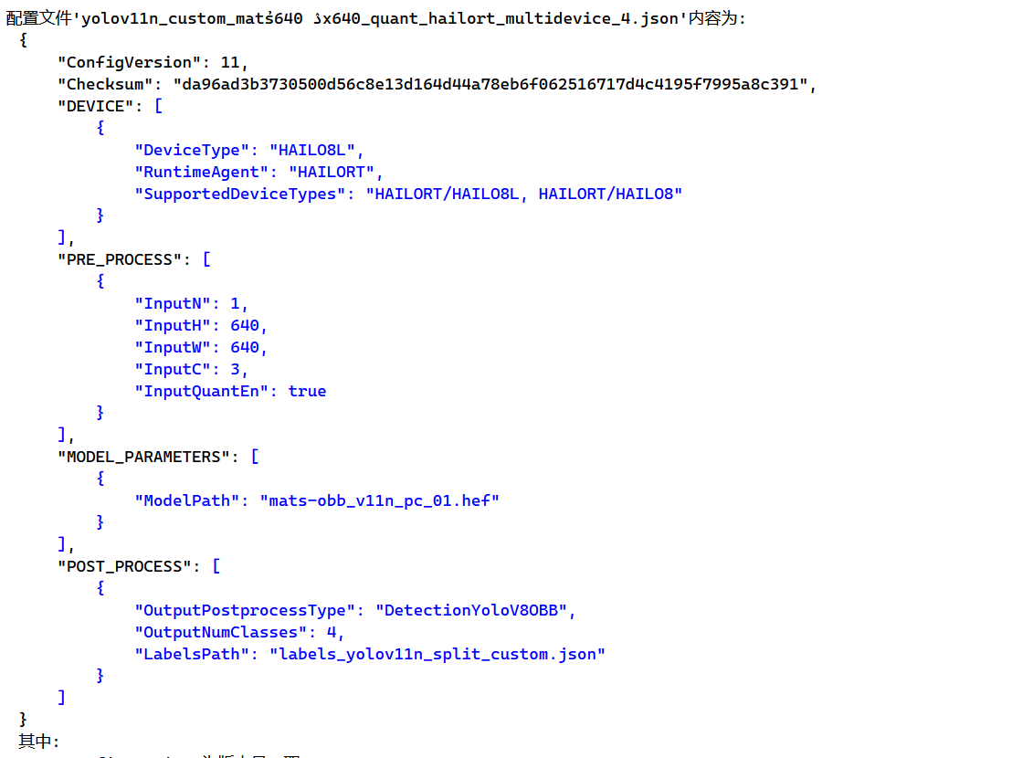

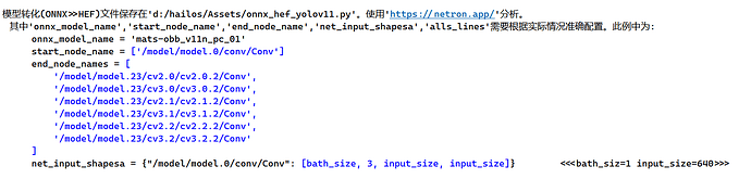

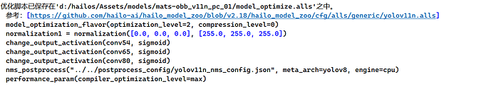

I encountered an error when running the Hailo accelerator card on a Raspberry Pi using the hex file converted by Dataflow Compiler v3.33.0:“YOLOv8 OBB Detection postprocessor expects 9 inputs, but model produces 1”.

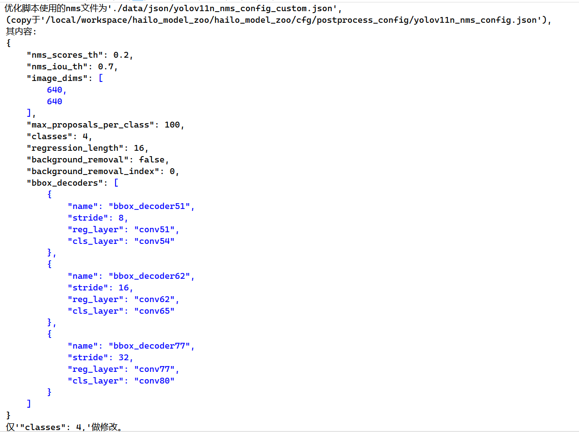

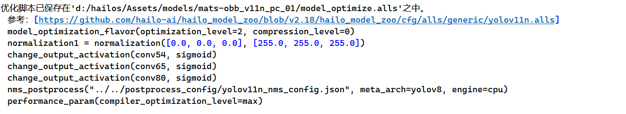

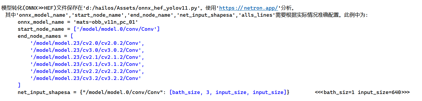

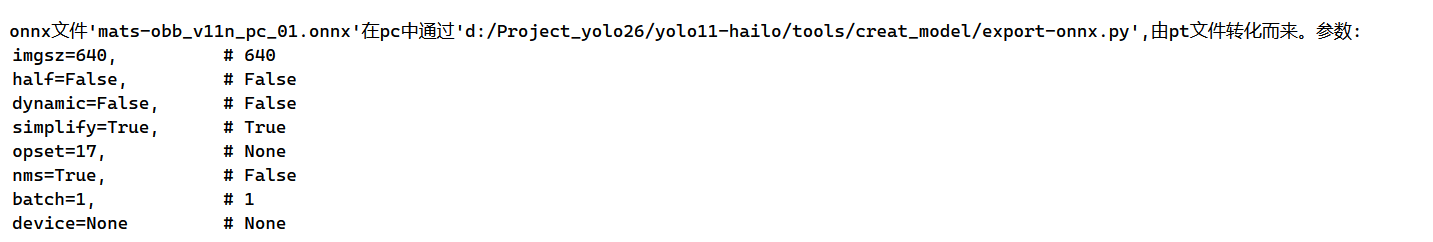

Hi, this error usually means the model was compiled with a single merged output instead of the separate convolution end nodes that the postprocessor expects. You might want to check how you exported your ONNX - for YOLOv8-OBB you typically need 9 separate end nodes (6 for standard detection + 3 for the angle branch), and you may need a custom .alls script to define them properly during compilation.
This might help: Is there any oriented bounding box model object detection
