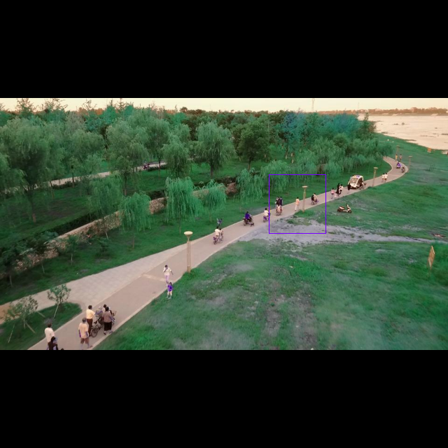

One question on this topic, does your answer above hold true for all YOLO models? Or only those based on YOLOv8?
The reason I ask is because I used the same code processing code to format the output for YOLOv5, and the values don’t make sense when plotted:
example_det = batch_dets[13]
print(f"batch detections shape: {batch_dets.shape}\n")
print(f"image detections shape: {example_det.shape}\n")
print(f"sample image transposed shape: {example_det[0].T.shape}\n")
print(f"sample image transpose, first row:\n{example_det[0].T[0]}\n")
[Output]:
batch detections shape: (532, 2, 5, 80)
image detections shape: (2, 5, 80)
sample image transposed shape: (80, 5)
[0.38911262 0.60026085 0.5215737  0.7272882  0.7160785 ]
Looks normal, yet when multiplied by 640, results in this:
Swapping the columns (or rather, since I was doing that for yolov11, not swapping the columns) also doesn’t give sensical results.
The only difference between the setup was the .alls script and the nms_config - not sure if I should be looking at fixing something in the quantization, or in the processing.
Hi @natsayin_nahin
The code should work for all models for which hailo provides nms postprocessing integration. Is the yolov5 you used above from the hailo model zoo? or did you compile it by yourself?
@shashi - you are correct, I went back an ran on the coco pretrained yolov5s model through the same pipeline I have for the visdrone yolo11 and visdrone yolo5, and it has valid detections. Which is somewhat bad news because it means there is actually catastrophic degradation occuring on parse/optimization.
Anyway, it is not a processing issue, but an optimisation one, so I’ll open a new thread for that
