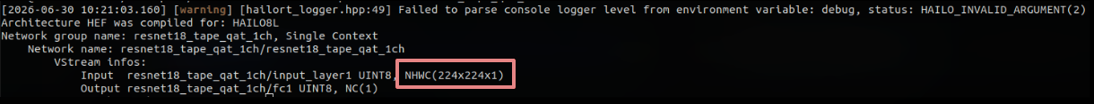

For most models you can just use the raw streams instead of the vstream. You can see the streams of the model using the following command:
hailortcli parse-hef --parse-streams model.hef
The HailoRT raw_stream and vstream examples are probably useful to have a look at.
In case the raw_stream does not have the NHCW format you can use the following Hailo Dataflow Compiler ALLS command to prevent the addition of the reshape operation:
allocator_param(automatic_reshapes=disabled)
