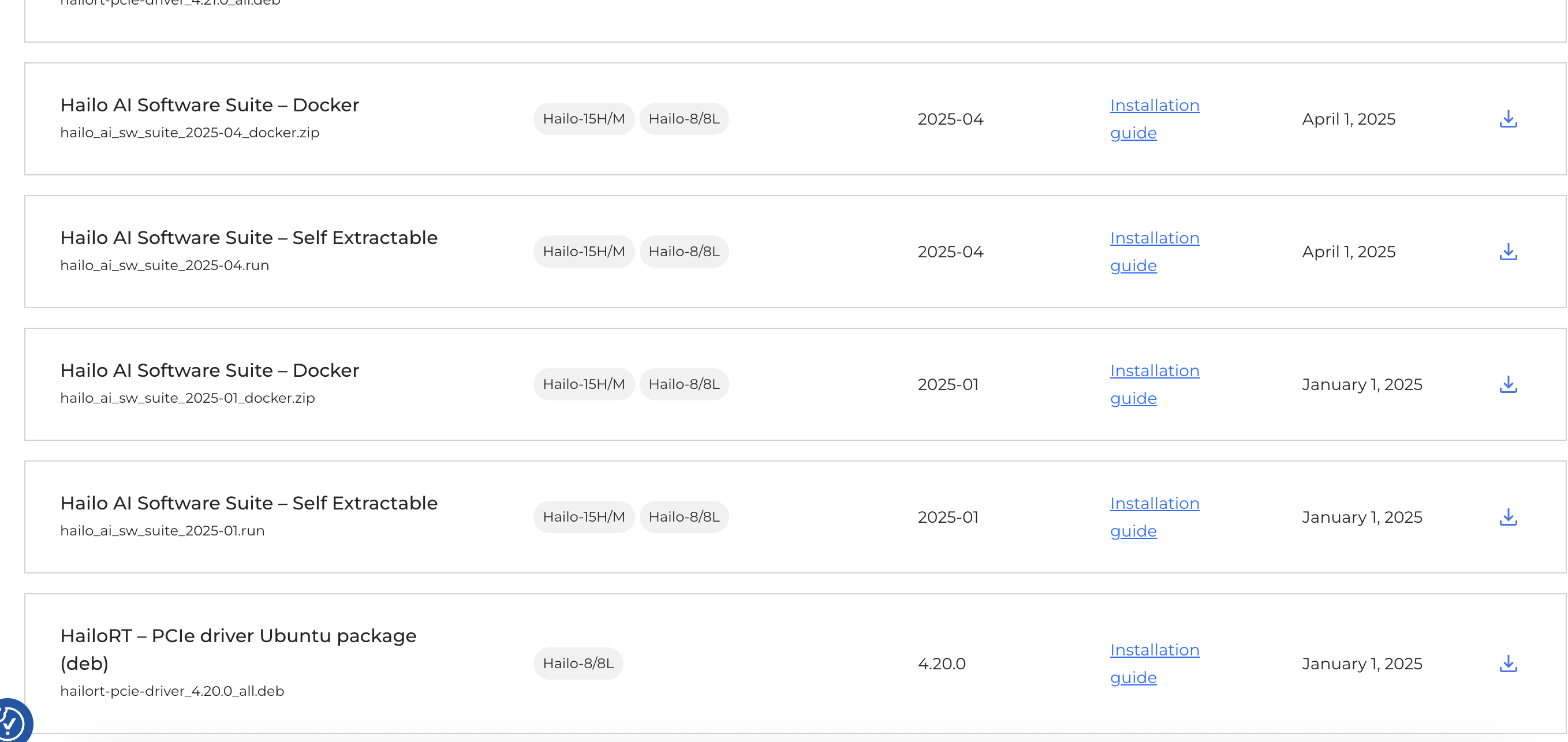

I am using a Raspberry Pi 5 with the latest Raspberry Pi OS. My kernel (uname -r output is 6.12.34+rpt-rpi-2712) has an in-tree Hailo driver version 4.20.0. I need the corresponding runtime package, hailort_4.20.0_arm64.deb, to match this driver version, but I cannot find it on your developer website. Could you please provide me with this file?

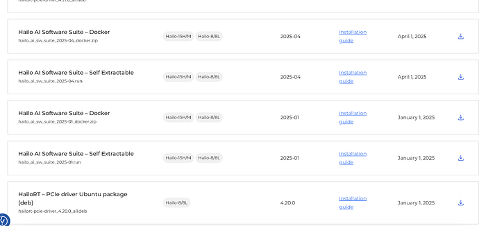

Merhaba Hatice siteye girdiğin zaman developer zona gir sonra versiyonların altında filter kısmı var onu archive çek ve aşağıya kayınca göreceksin
Hey @hatice_karaca,
To get started on your Raspberry Pi, you’ll want to install the hailo-all package. Just run this command:
sudo apt install hailo-all
