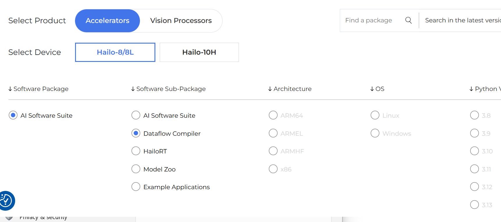

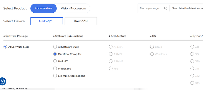

Hello, thank you for your response. please which .whl files should i download. the 8/8L section does not have a dataflow compiler
Hi @user805 ,
In Hailo Developer Zone there is a filter on top for Hailo-8.
Current DFC version is 3.33

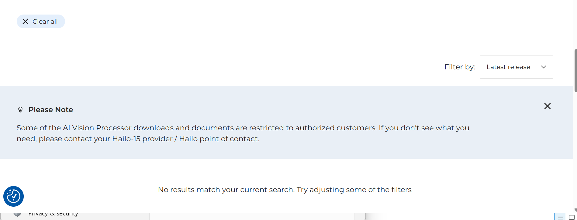

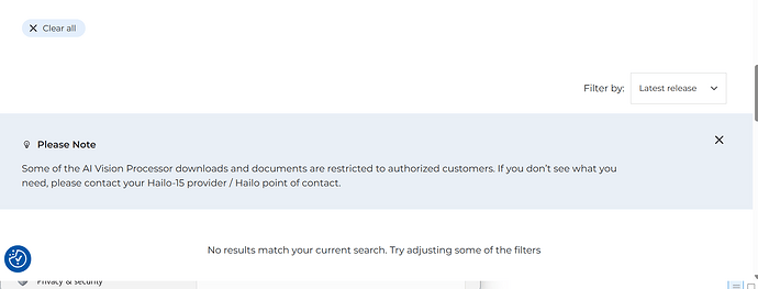

theres nothing there for me
