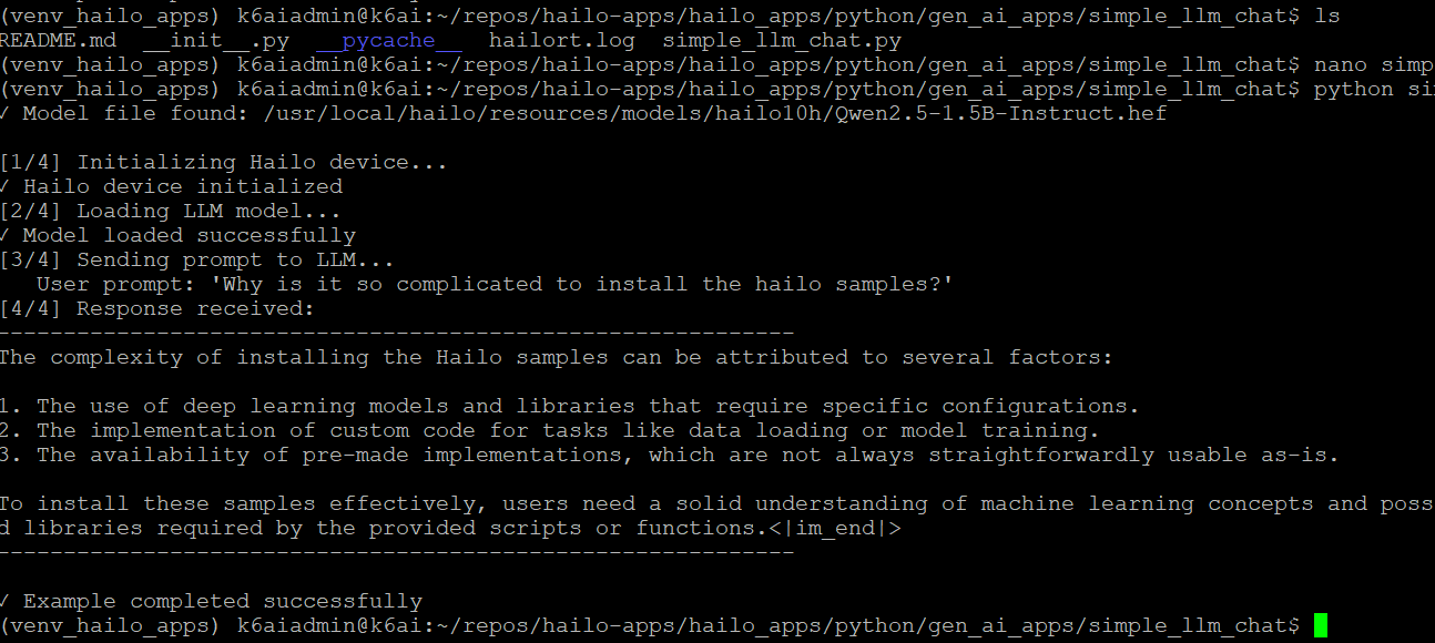

Problem is resolved by changing the hostname of my pi 5 to “rpi”. RPI_POSSIBLE_NAME = [“rpi”, “raspberrypi”, “pi”] in defines.py. The Hostname can’t be anything else for installation to work. After changing my hostname the installation completed sucessfully.
@BryanSwie Thanks for the input - we appreciate it! We will check and implement a fix ASAP.
Got it working with variable hailort. Still was getting error in post-installation steps tappas not installed/detected. Also missed some other dependencies in the venv.
#babysteps
@BryanSwie In our latest hailo-apps release this fix is implemented.
