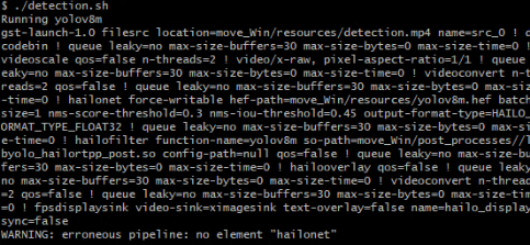

i’m testing HailoRT in Windows 10 environment
hailortcli run my_model.hef is working
but my gstreamer pipeline isn’t working
( same file works well on Ubuntu OS )
Warning : erroneous pipeline : no element “hailonet”
Warning : erroneous pipeline : no element “gsthailo”

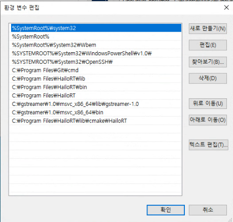

hailonet
환경변수세팅
