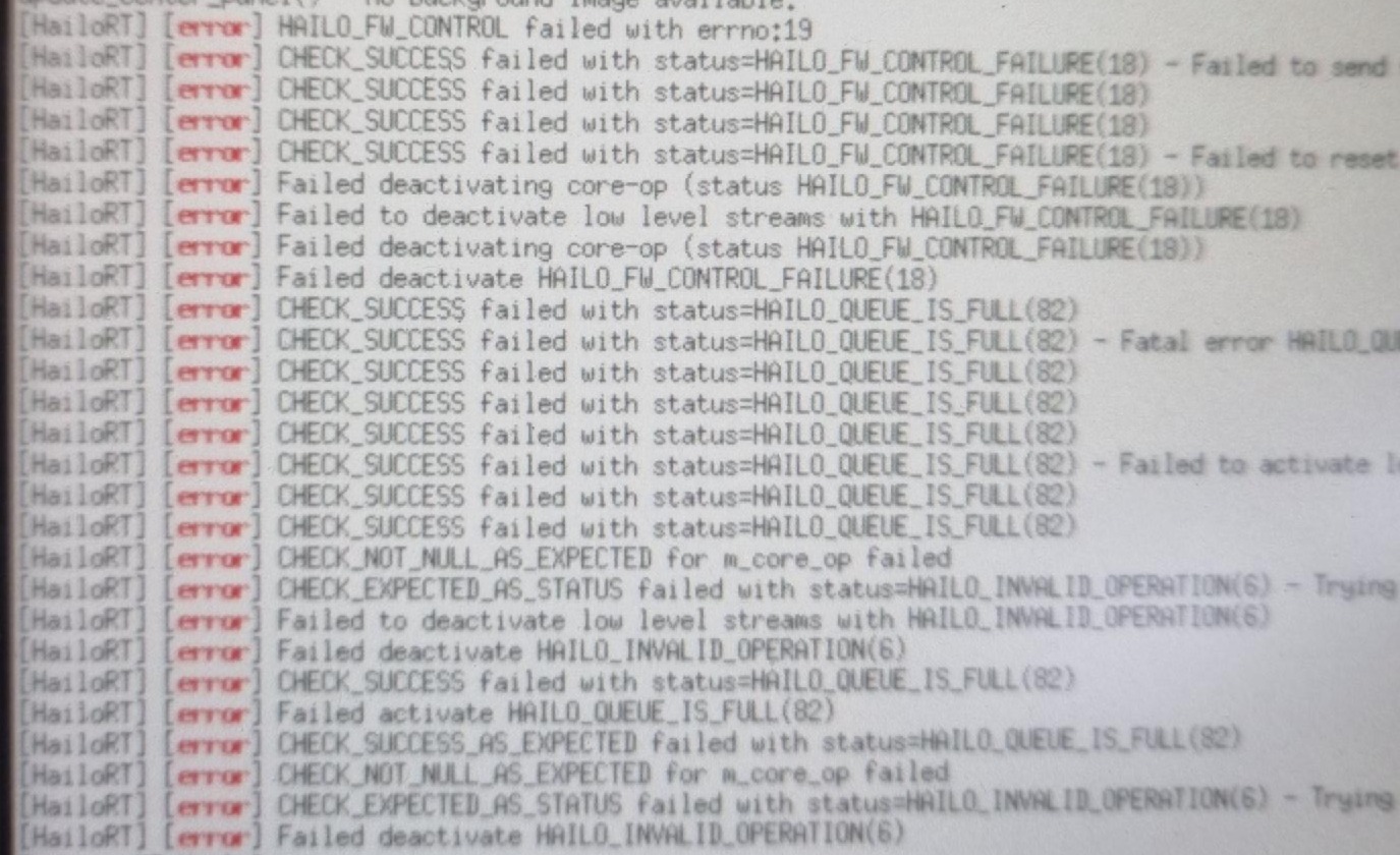

The main issue that reoccurs is [HailoRT][error] HAILO_FW_CONTROL failed with errno:19. The error messages that follow tend to be [HailoRT][error] CHECK_SUCCESS failed with status=HAILO_FW_CONTROL_FAILURE(18) - failed to send fw control. Apologies for the spam; been debugging all morning.

With 4.16.0, I get this error from HailoRT whilst running the application with Python 3.8:

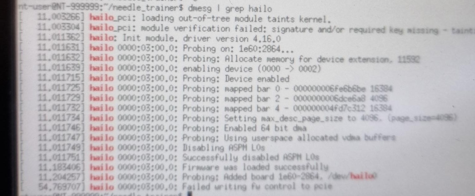

Here is the output from dmesg | grep hailo. Also with 4.16.0:
One thing I have noticed is that setting pci=nomsi and pci_aspm=off in the grub (and then running sudo update-grub) appears to drastically increase stability and these errors happen at a much lower frequency. The pci=nomsi appears to be most important factor that increases stability.
