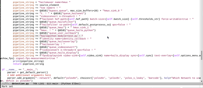

@sanjoyg we have noticed that the issue only happens when running the element using gst-launch.
While we work on a solution, you can add the hailopython to a GStreamer pipeline with Python on top.
For example, on the detection basic pipeline, you can add it as follows:
Thank you for reporting the issue to us, we will update here once it is solved.
