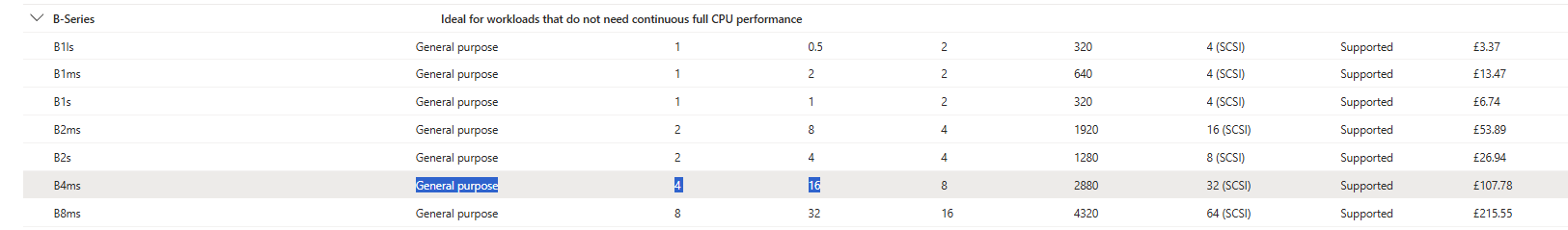

I plan to run Ubuntu on an Azure virtual machine, as I’ve read that the latest Ubuntu has dual-boot issues with Windows 10. I don’t want to risk corrupting anything on my PC. Do you recommend any particular VM series? I don’t mind it taking an additional hour of processing if I can use a more economical series. Alternatively, can this be run on an Apple Mac?
Regarding Azure, I was considering the highlighted option. From what I’ve read on one of the GitHub repositories, an RTX 4080 was used, so I assume the GPU should be equivalent to that? This is from Azure

We do not validate our tools with VMs.

@KlausK For the retraining, we have a Windows PC with a basic GPU NVidia GTX1600, so we might need a Virtual Machine. What spec should I create this? Is there a minimum specification I should follow?

You will need to check this for each model. In general for model training bigger is better. This is a classical "What do you have more? Time or money? question.
Unfortunately, the GTX1600 does not look like a good fit. Maybe for a small model with reduced batch-size.
