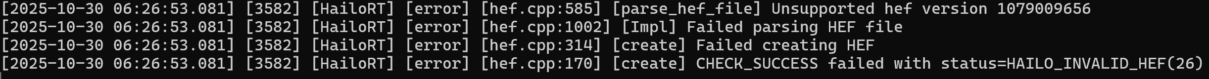

HAILO_INVALID_HEF, Unsupported hef version 1079009656
Hi, so i’m compiling my hef from my laptop and when I’m trying to run my custom hef file on rasberrypi5. it give me this error

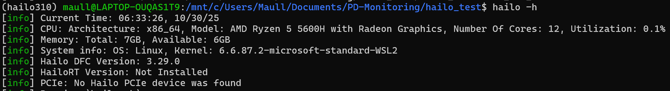

the version dfc i alr try to use is 3.30, 3.29 and 3.31
for my hailort version on my raspi is

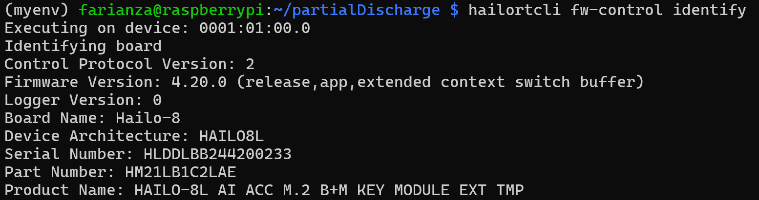

this is my hailo device

any ideas how to solve this error?

Thank you so much! I managed to solve the error by re-reading the documentation and applying your solution. It’s working perfectly now
