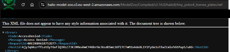

I have tried the link below and it gives me this:
https://hailo-model-zoo.s3.eu-west-2.amazonaws.com/ModelZoo/Compiled/v2.16.0/hailo8/tiny_yolov4_license_plates.hef
and the same for the re-id link:
https://hailo-model-zoo.s3.eu-west-2.amazonaws.com/ModelZoo/Compiled/v2.16.0/hailo8/repvgg_a0_person_reid_2048.hef
Thank you in advance.
Hey @Markus_Oosthuizen ,
Welcome to the Hailo Community !
This might be a broken link , We will fix it!
I am having the same problem, I just purchased this hardware based on these models being available. The link is still broken.
Can you please fix the link or let us know where to find a working version of tiny_yolov4_license_plates.hef?
Hi @dreamily9869,
We’re making sure to solve this as soon as possible. Meanwhile, you can download the hef for H8 compiled with the latest DFC here:
https://hailo-csdata.s3.eu-west-2.amazonaws.com/resources/hefs/h8/tiny_yolov4_license_plates.hef
