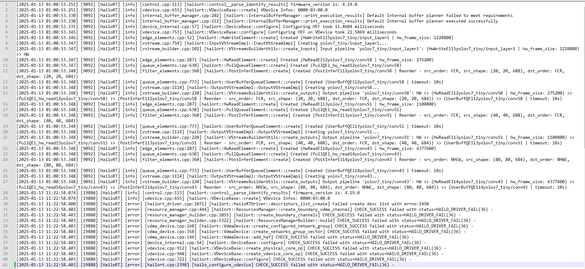

hailort.log:
As shown in the logs, at [2025-01-13 01:00:53.251], I started the application, successfully initialized the Hailo device, and performed inference without any issues.
However, at [2025-01-13 11:22:58.074], after closing and restarting the application, the HAILO_DRIVER_FAIL error occurred.
