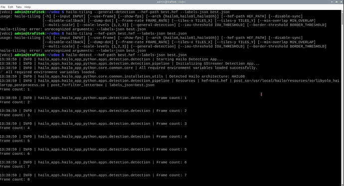

Am unbale to access the “–labels-json” (declared along with – hef-path) configuration parameter for a custom/re-trained .hef file for hailo-multisource and and hailo-tiling. Spits out that “–labels-json” is an unrecognized parameter.
But “–labels-json” (along with --hef-path) works perfectly ok for hailo-detect.

When using with hailo-tiling –general-detection (for using a custom Yolov8m) it says:
(vdcc) admin@trafitek:~/vdcc $ hailo-tiling --general-detection --hef-path best.hef --labels-json best.json
usage: hailo-tiling [-h] [–input INPUT] [–use-frame] [–show-fps] [–arch {hailo8,hailo8l,hailo10h}] [–hef-path HEF_PATH] [–disable-sync]
[–disable-callback] [–dump-dot] [–frame-rate FRAME_RATE] [–tiles-x TILES_X] [–tiles-y TILES_Y] [–min-overlap MIN_OVERLAP]
[–multi-scale] [–scale-levels {1,2,3}] [–general-detection] [–iou-threshold IOU_THRESHOLD] [–border-threshold BORDER_THRESHOLD]
hailo-tiling: error: unrecognized arguments: --labels-json best.json
When using with hailo-tiling it says:
(vdcc) admin@trafitek:~/vdcc $ hailo-tiling --hef-path best.hef --labels-json best.json
When using with hailo-detect it works
(vdcc) admin@trafitek:~/vdcc $ hailo-detect --hef-path best.hef --labels-json best.json

Would appreciate incase you can help with the challenge that i am facing.

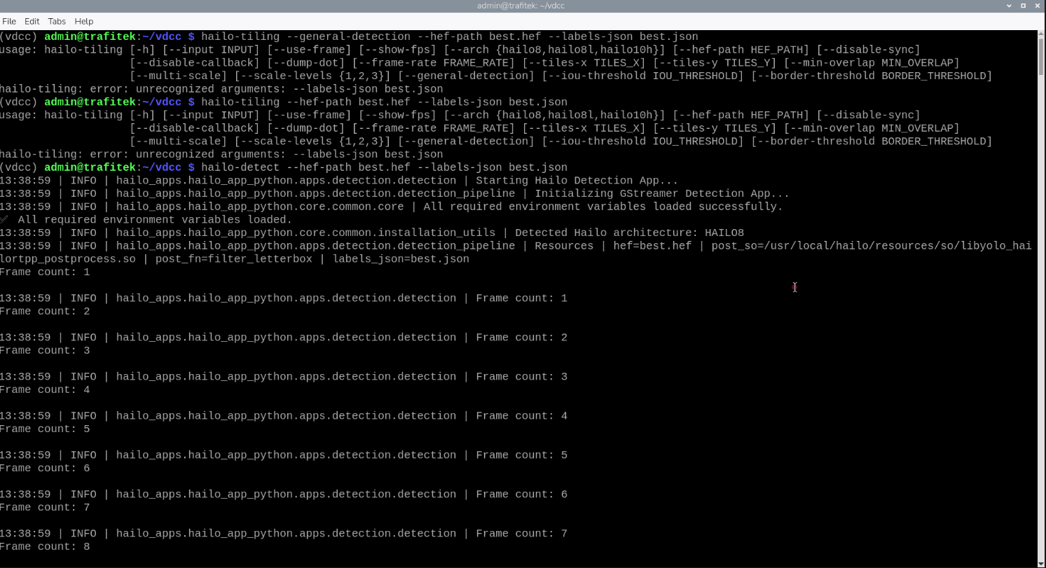

The error in console output says:
However whenever I use the hailo-detect primitive with --labels-json best.json it does not give any error and executes correctly.
Please refer to the screenshot for both the scenarios as they appear and which I have already provided.
