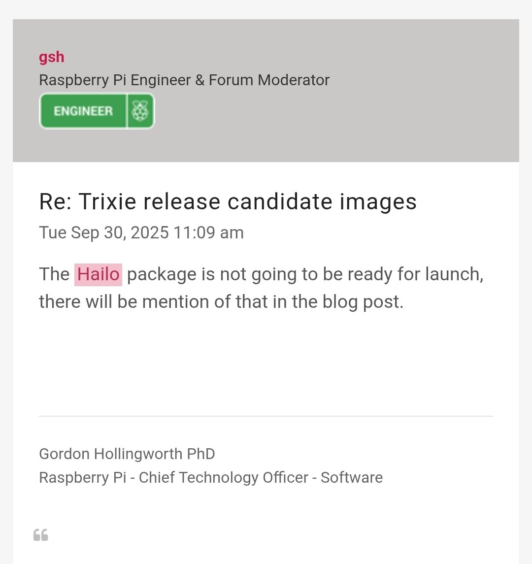

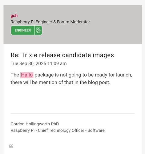

Last I checked on the Raspberry Forum, the hailo packages were still not available yet for the new OS. I flashed a new debian 12 bookworm and went back to the previous OS. Will check in from time to time because the new OS did look nice.
Hey @Adam_Yates ,
It should be out soon!
We wll update the community!
