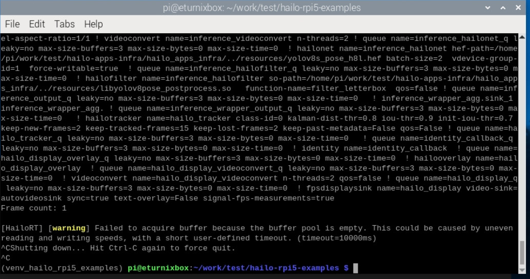

This is the error:
Just to point out that, with hailo-apps-infra checked out or not, often pose_estimation with input a media file doesn’t start.
Sometimes happen also with detection, but with pose_estimation it doesn’t work almost always. With input rpi the script works great.
