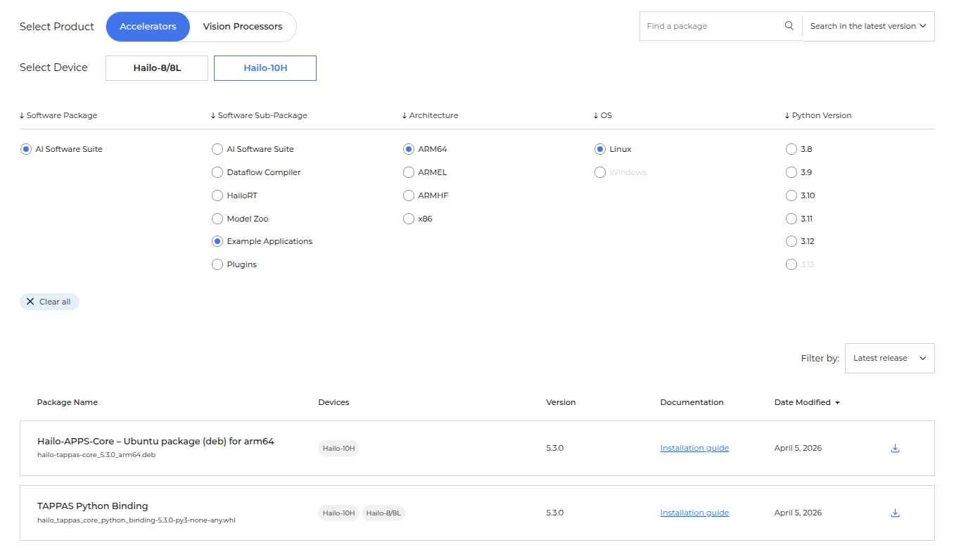

where can I get 5.3.0 of hailo-tappas-core? It’s not provided in the Downloads section of the Developer Zone even after selecting the correct filters.
Thanks!

Tks, I’m referring to the TAPPAS Core .deb package though (and not the Core Bindings wheels) cos I want to work with the GStreamer pipeline apps.
Where can I get the Core .deb?
Or are you saying that the Wheels can be used for this too?
ok I see it now: hailo-tappas-core_5.3.0_arm64.deb .
It disappears when any of the Python versions is selected.
