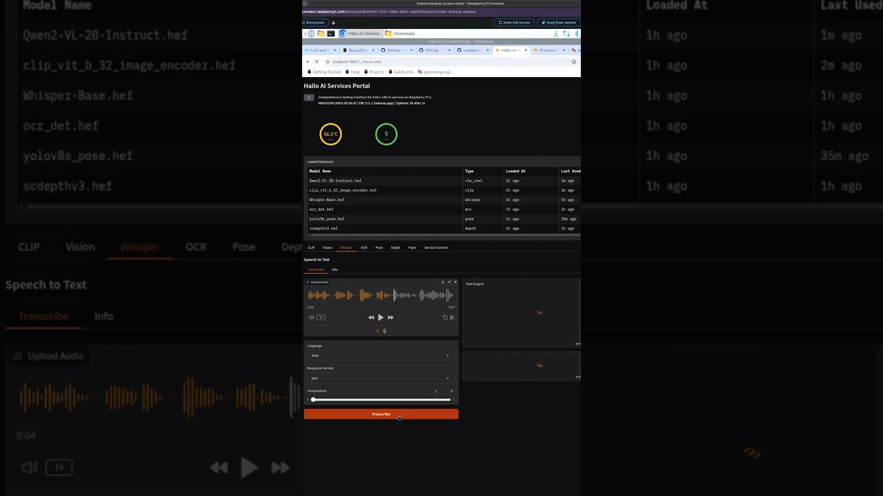

So I repackaged the Hailo-provided Qwen2-VL, CLIP, Whisper, OCR, Pose, and Depth services (and the CPU-only Piper service) to run as system services on the Raspberry Pi, and coded a “device manager” to manage the “VDevice” allocation to each service in turn on demand via APIs and queuing.
Here is a demo video! I coded up a gradio interface to allow easy testing / demonstration of all of the APIs running on my Raspberry Pi with Hailo-10H:
