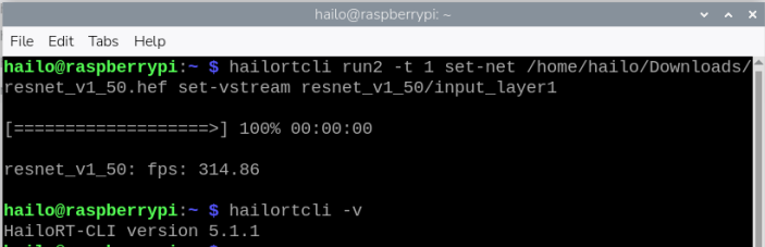

I also physically reconnected / reseated the AI HAT+ 2 and repeated the same direct run2 test. The result was unchanged:
[===================>] 100% 00:00:00
resnet_v1_50: fps: 0.00
[HailoRT] [error] CHECK failed - Waiting for async pipeline to be ready has timed out!

I have a similar setup with exact same symptoms. After a cold restart, extracting the runtime logs (hailortcli logs runtime) , there seems to be a a failure:
Mar 9 12:34:59 hailo10 kern.err kernel: ina2xx_precise 0-0040: INA2xx detection failed (manufacturer ID mismatch or read error): -121
Mar 9 12:34:59 hailo10 kern.warn kernel: ina2xx_precise: probe of 0-0040 failed with error -121
is this a cause of the issue and indicating the board has defects?

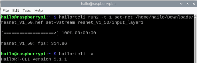

@user792 @user737
Did some frames passed and then stopped, or never worked at all?
No, never worked at all.
For the reference, this is the runtime log after executing hailortcli run2 -t 1 set-net /usr/share/hailo-models/resnet_v1_50_h10.hef set-vstream resnet_v1_50/input_layer1
Mar 9 17:59:07 hailo10 kern.info kernel: hailo_pci_ep_driver 222000.hailo_pci_ep_driver: Changed device state to D0
Mar 9 17:59:07 hailo10 user.info HailoRT-Server: [vdevice.cpp:227] [create] Creating vdevice with params: device_count: 1, scheduling_algorithm: ROUND_ROBIN, multi_process_service: false
Mar 9 17:59:07 hailo10 user.info HailoRT-Server: [device.cpp:53] [Device] OS Version: Linux 5.15.325.15.32-yocto-standard-01576-g55eda3b378bf #1 SMP PREEMPT Wed Oct 29 18:22:56 UTC 2025 aarch64
Mar 9 17:59:07 hailo10 user.info HailoRT-Server: [control.cpp:102] [control__parse_identify_results] firmware_version is: 5.1.1
Mar 9 17:59:07 hailo10 user.info HailoRT-Server: [vdevice.cpp:367] [create] VDevice Infos: [integrated]
Mar 9 17:59:07 hailo10 user.info HailoRT-Server: [internal_buffer_manager.cpp:77] [print_execution_results] Planned internal buffer memory: CMA=64000 CMA-Desc=0 Pinned=0. memory to edge layer usage factor is 1
Mar 9 17:59:07 hailo10 user.info HailoRT-Server: [internal_buffer_manager.cpp:86] [print_execution_results] Default Internal buffer planner executed successfully
Mar 9 17:59:07 hailo10 user.info HailoRT-Server: [device_internal.cpp:61] [configure] Configuring HEF took 48.2146 milliseconds
Mar 9 17:59:07 hailo10 user.info HailoRT-Server: [vdevice.cpp:465] [configure] Configuring HEF on VDevice took 48.57888 milliseconds
Mar 9 17:59:07 hailo10 user.info HailoRT-Server: [infer_model.cpp:424] [configure] Configuring network group β€˜resnet_v1_50’ with params: batch size: 0, power mode: PERFORMANCE, latency: NONE
Mar 9 17:59:07 hailo10 user.info HailoRT-Server: [multi_io_elements.cpp:759] [create] Created (AsyncHwEl)
Mar 9 17:59:07 hailo10 user.info HailoRT-Server: [queue_elements.cpp:451] [create] Created (EntryPushQEl0resnet_v1_50/input_layer1 | timeout: 10s)
Mar 9 17:59:07 hailo10 user.info HailoRT-Server: [filter_elements.cpp:104] [create] Created (PreInferEl16resnet_v1_50/input_layer1 | Reorder - src_order: NHWC, src_shape: (224, 224, 3), dst_order: NHCW, dst_shape: (224, 224, 3))
Mar 9 17:59:07 hailo10 user.info HailoRT-Server: [queue_elements.cpp:451] [create] Created (PushQEl16resnet_v1_50/input_layer1 | timeout: 10s)
Mar 9 17:59:07 hailo10 user.info HailoRT-Server: [edge_elements.cpp:188] [create] Created (LastAsyncEl0AsyncHwEl)
Mar 9 17:59:07 hailo10 user.info HailoRT-Server: [pipeline.cpp:896] [print_deep_description] EntryPushQEl0resnet_v1_50/input_layer1 | inputs: user | outputs: PreInferEl16resnet_v1_50/input_layer1(running in thread_id: 794)
Mar 9 17:59:07 hailo10 user.info HailoRT-Server: [pipeline.cpp:896] [print_deep_description] PreInferEl16resnet_v1_50/input_layer1 | inputs: EntryPushQEl0resnet_v1_50/input_layer1[0] | outputs: PushQEl16resnet_v1_50/input_layer1
Mar 9 17:59:07 hailo10 user.info HailoRT-Server: [pipeline.cpp:896] [print_deep_description] PushQEl16resnet_v1_50/input_layer1 | inputs: PreInferEl16resnet_v1_50/input_layer1[0] | outputs: AsyncHwEl(running in thread_id: 795)
Mar 9 17:59:07 hailo10 user.info HailoRT-Server: [pipeline.cpp:896] [print_deep_description] AsyncHwEl | inputs: PushQEl16resnet_v1_50/input_layer1[0] | outputs: LastAsyncEl0AsyncHwEl
Mar 9 17:59:07 hailo10 user.info HailoRT-Server: [pipeline.cpp:896] [print_deep_description] LastAsyncEl0AsyncHwEl | inputs: AsyncHwEl[0] | outputs: user
Mar 9 17:59:07 hailo10 user.info HailoRT-Server: [scheduled_core_op_state.cpp:76] [set_threshold] Setting scheduler threshold of resnet_v1_50 to 0 frames
Mar 9 17:59:07 hailo10 user.info HailoRT-Server: [scheduled_core_op_state.cpp:66] [set_timeout] Setting scheduler threshold timeout of resnet_v1_50 to 0ms
Mar 9 17:59:07 hailo10 user.info HailoRT-Server: [scheduled_core_op_state.cpp:87] [set_priority] Setting scheduler priority of resnet_v1_50 to 16
Mar 9 17:59:17 hailo10 user.info HailoRT-Server: [async_infer_runner.cpp:88] [shutdown] Pipeline was aborted. Shutting it down
Mar 9 17:59:17 hailo10 user.info HailoRT-Server: [network_group.cpp:768] [operator()] Infer request was aborted by user

Hi @user792 @user737 ,
We are on it and investigating.
Will keep you posted here.
Hi @user792, @user737
Can you please provide link from where the relevant HEF’s downloaded from?
Since when we tried on our official Model Zoo HEF, it worked:
Hi Michael,
I used the official sources as instructed for the installation, cloned the github repository GitHub - hailo-ai/hailo-apps Β· GitHub
I am able to reproduce this with using hailo-ollama as well so the issue is not with the HEF only.
I did run my logs after separate tries through Claude-AI to compile findings:
Board: Raspberry Pi AI HAT+ 2, board-sku-6 (Hailo10 RPI 8GiB) Packages: all 5.1.1 β€” h10-hailort, h10-hailort-pcie-driver, hailo-gen-ai-model-zoo Config: PCIe Gen3 enabled, ASPM disabled (confirmed via lspci), device in D0
Issue: vDMA never transfers any data. Pipeline configures successfully every time, but inference always times out with 0 frames transferred.
Key findings from hailortcli logs runtime:
  1. On every boot: ina2xx_precise 0-0040: INA2xx detection failed (manufacturer ID mismatch or read error): -121
  2. Pipeline configures successfully (~48ms for vision, ~1600ms for LLM)
  3. After exactly 10s timeout: Queue element [...] has 0 frames in his Queue on destruction
  4. Device immediately cycles back to D3hot after every failed inference
  5. Reproduced consistently across resnet vision HEF, qwen2:1.5b, and llama3.2:3b
