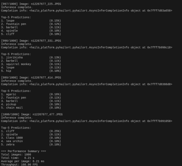

Thanks, actually, the examples helped. I have managed to run one of your models in the model zoo(mobilenetv1 classification). I am getting extremely low prediction scores considering i am testing on the imagenet dataset,also, how have you measured the fps because I am getting really low throughput compared to your results
Hey, about the FPS issue - make sure you’ve enabled Gen 3.0 PCIe, and then check the actual speed by running hailortcli run model.hef.
The RPi only has 1 PCIe lane, and those results you’re seeing in the model zoo are based on 2 lanes. So with larger models, you might notice a bit of a difference in performance.
As for the prediction scores, could you share some of your results with me?
Sure, here are the results, also you can see below the fps I am getting. I am running it asychronously and including this hailo_infer.last_infer_job.wait(10000) to ensure the inference takes place first before calculating the time
