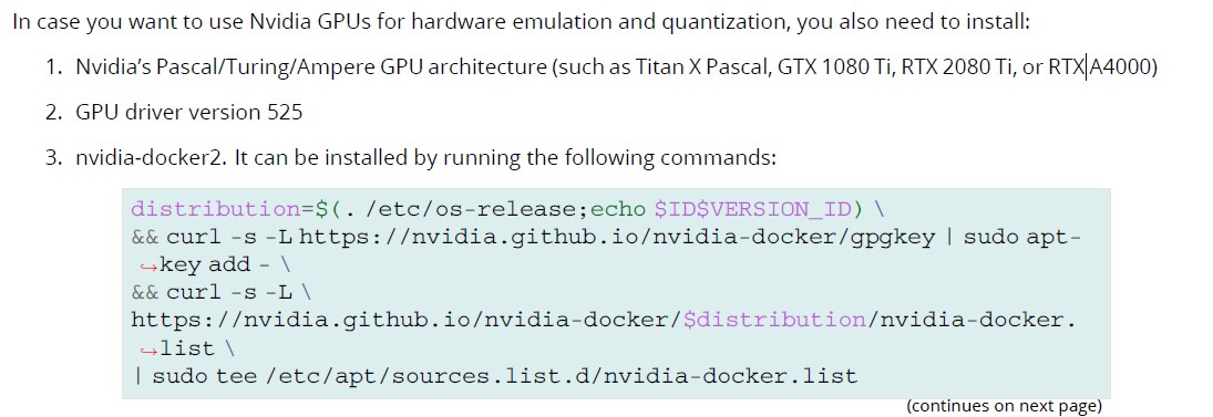

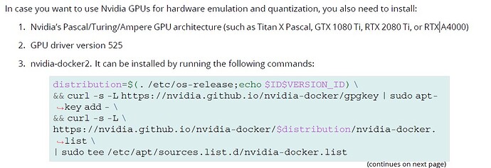

Hi, KlausK
Is the following the script you mentioned ?
I tried the script above, but it looks not work.
After running
hailo@W790WS:~/hailo8$ distribution=$(. /etc/os-release;echo $ID$VERSION_ID) && curl -s -L https://nvidia.github.io/nvidia-docker/gpgkey | sudo apt-key add - && curl -s -L https://nvidia.github.io/nvidia-docker/$distribution/nvidia-docker.list | sudo tee /etc/apt/sources.list.d/nvidia-docker.list
I get the following the warning Message:
Warning: apt-key is deprecated. Manage keyring files in trusted.gpg.d instead (see apt-key(8)).
gpg: 有効なOpenPGPデータが見つかりません。
What shall I do next? or anything else I can do?
