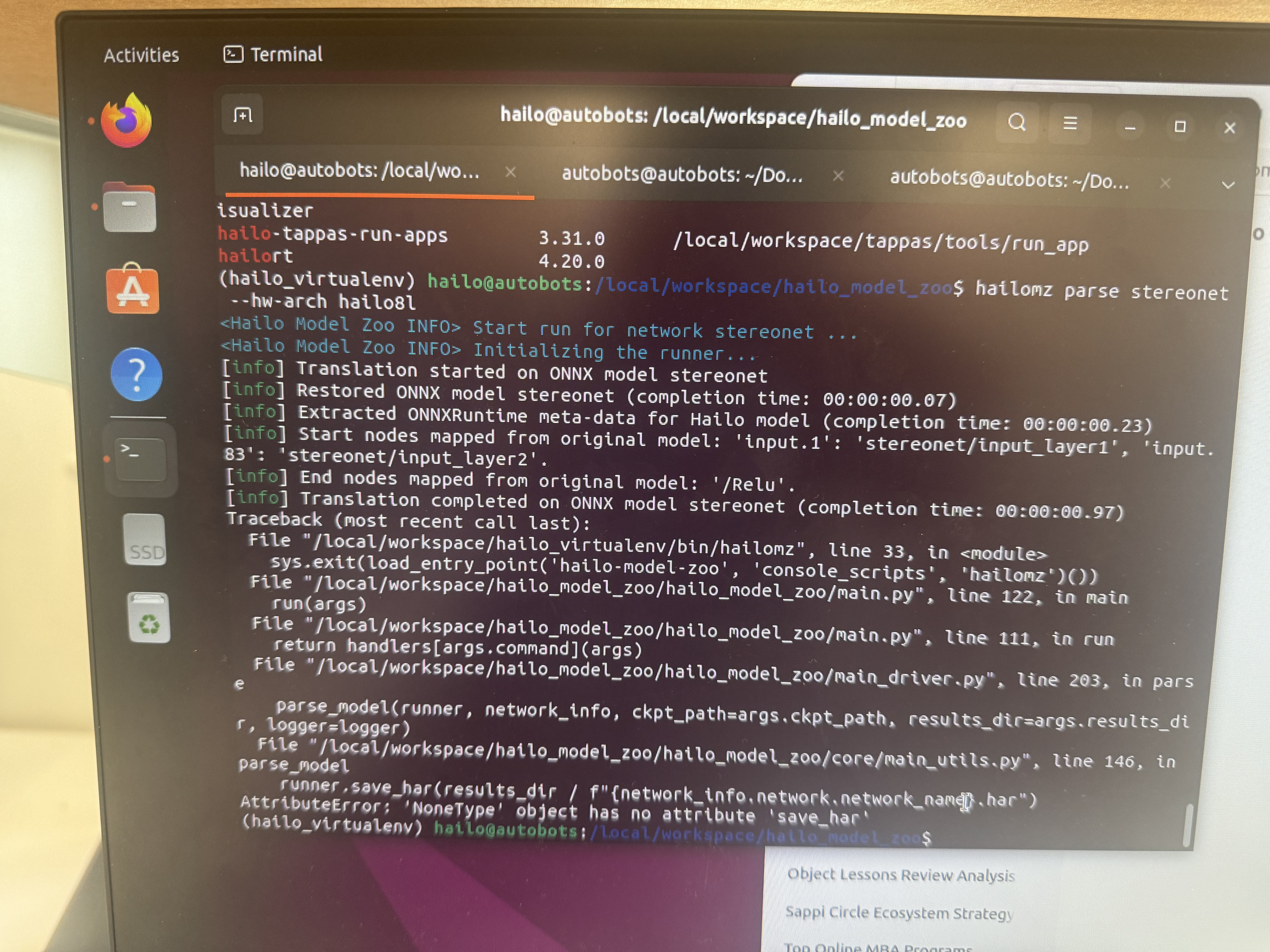

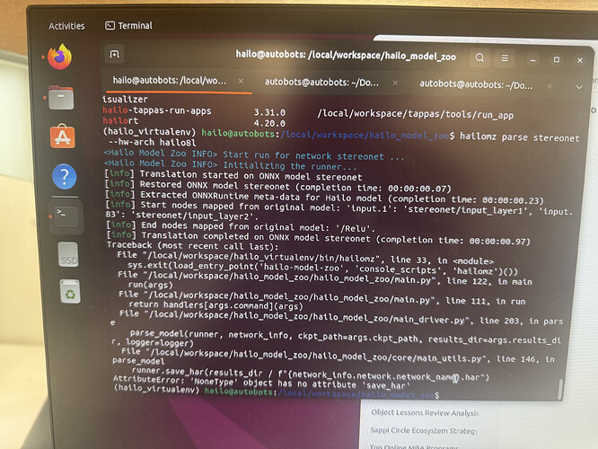

attribute error ‘NoneType’ object has no attribute save_har
The stereonet is only supported on Hailo-8. See the following page:
GitHub - Hailo Model Zoo - Public Models
The stereonet model has 6 contexts for Hailo-8 and runs 10 FPS. So compiling it to Hailo-8L does not seem to be useful and feasible.
I am not sure about the error message you get. I can run the command hailomz parse successfully in the Hailo AI Software Suite Docker 2025-01. However, I could not compile the model to Hailo-8L.
