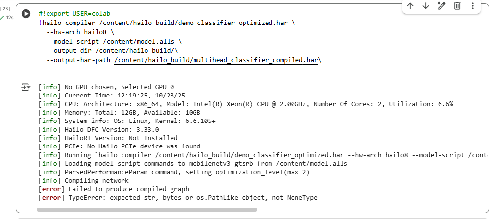

Hi everyone, here is the error I got while compiling:

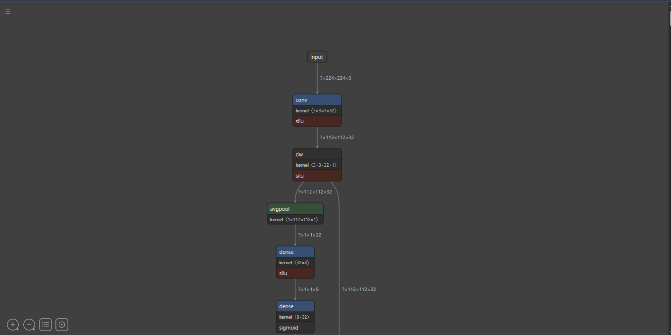

Looking at the generated .har file after optimization with Netron app it seems pretty okay:

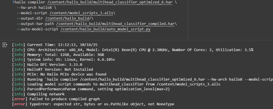

I think the issue is that the DFC is getting confused because you’re passing both --model-script and --auto-model-script at the same time. Normally you’d use one or the other—--model-script for .alls or .json files, or --auto-model-script for a .py dictionary.
Running both together isn’t really supported in most workflows. The only time you’d typically need both is in some edge cases, like when you’re compiling a pre-parsed multihead .har file and adding custom logic from auto_model_script.py.
Try removing one of those flags and see if that helps!
Hi @omria ,
I still end up getting the same error. Have a look:
I would appreciate any hints on what is actually causing the issue

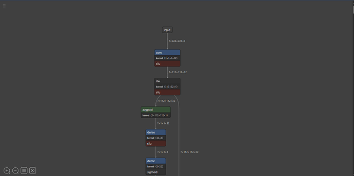

Okay, so to help me figure out what’s going on, could you share some screenshots of the nodes at the end of each output? Or if it’s easier, just send over the HAR file.
