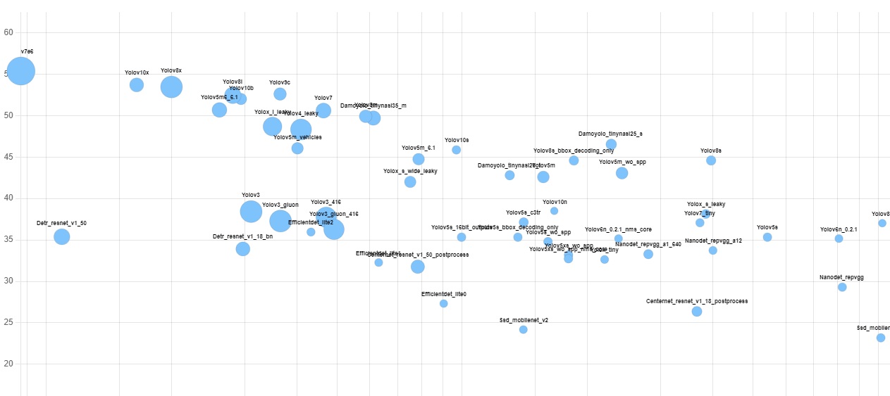

BTW, if you are interested in objected detector, with (a much better) tradeoff, I suggest taking a look in our model explorer:
