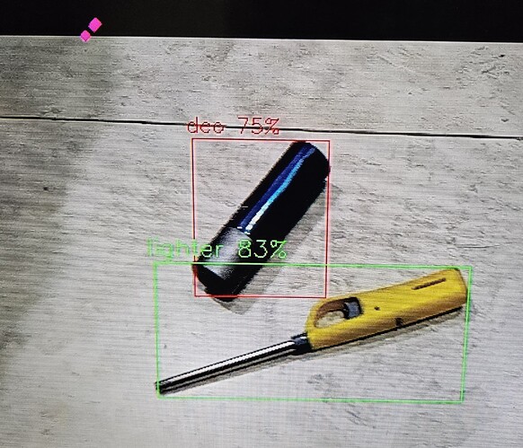

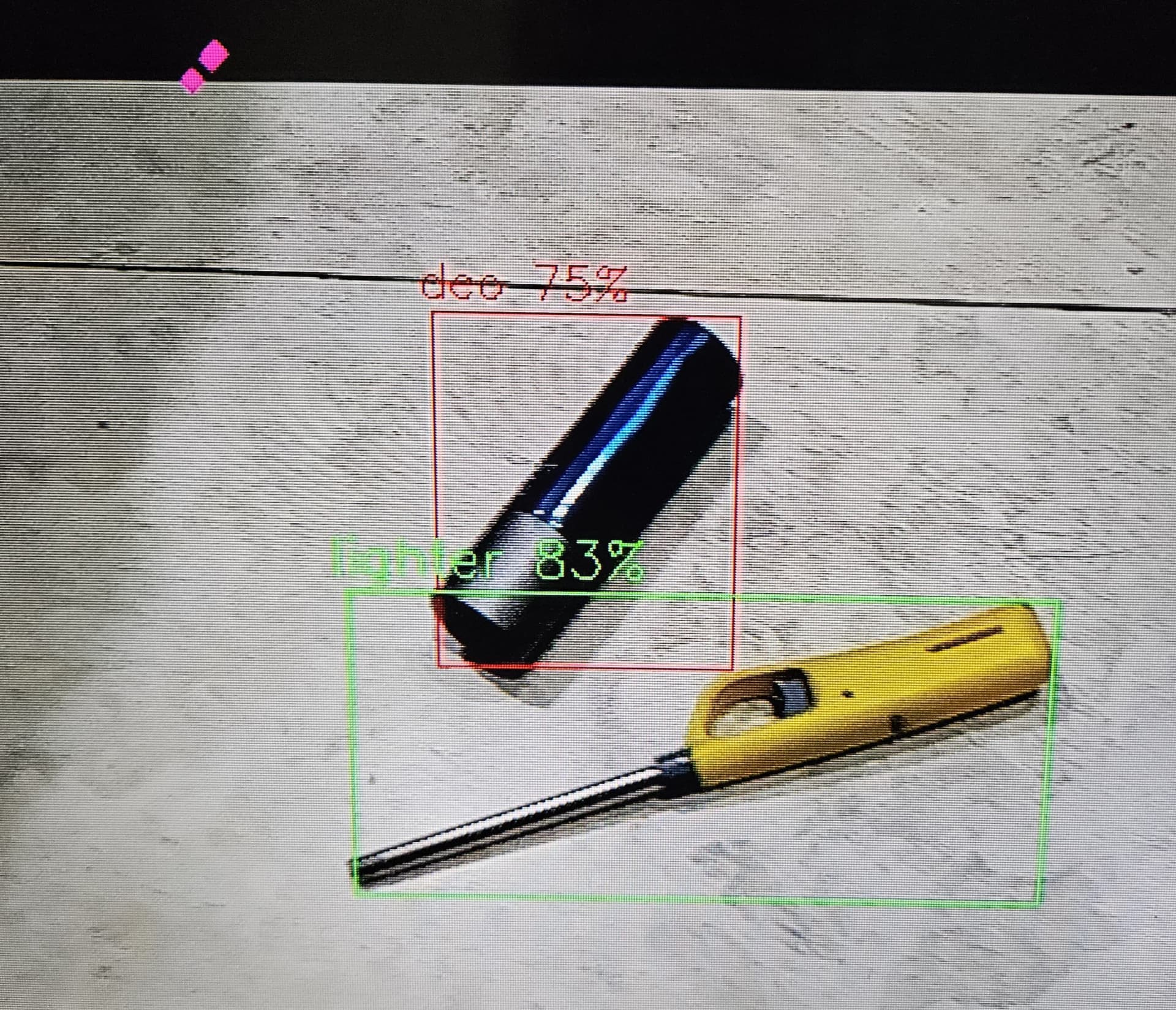

  • :white_check_mark: Bounding boxes work perfectly - I can see both “deo” and “lighter” objects detected with correct labels
  • :cross_mark: Keypoints are missing - I should see 2 keypoints inside the “deo” bbox and 3 keypoints inside the “lighter” bbox, but they don’t appear at all
  • :cross_mark: Only 2 dots visible - These appear outside any bounding box. One dot is larger than the other, which makes me suspect the keypoints might be overlapping at the same location. They move in tandem wrt bboxes

Your keypoints are all clustered at (0, 0.304xx) because you’re either reading the wrong tensor indices or missing the anchor/stride calculations for your conv45/conv59/conv72 layers. Plus that “two dots moving together” thing? Classic sign that you’re truncating your keypoint array too early.
