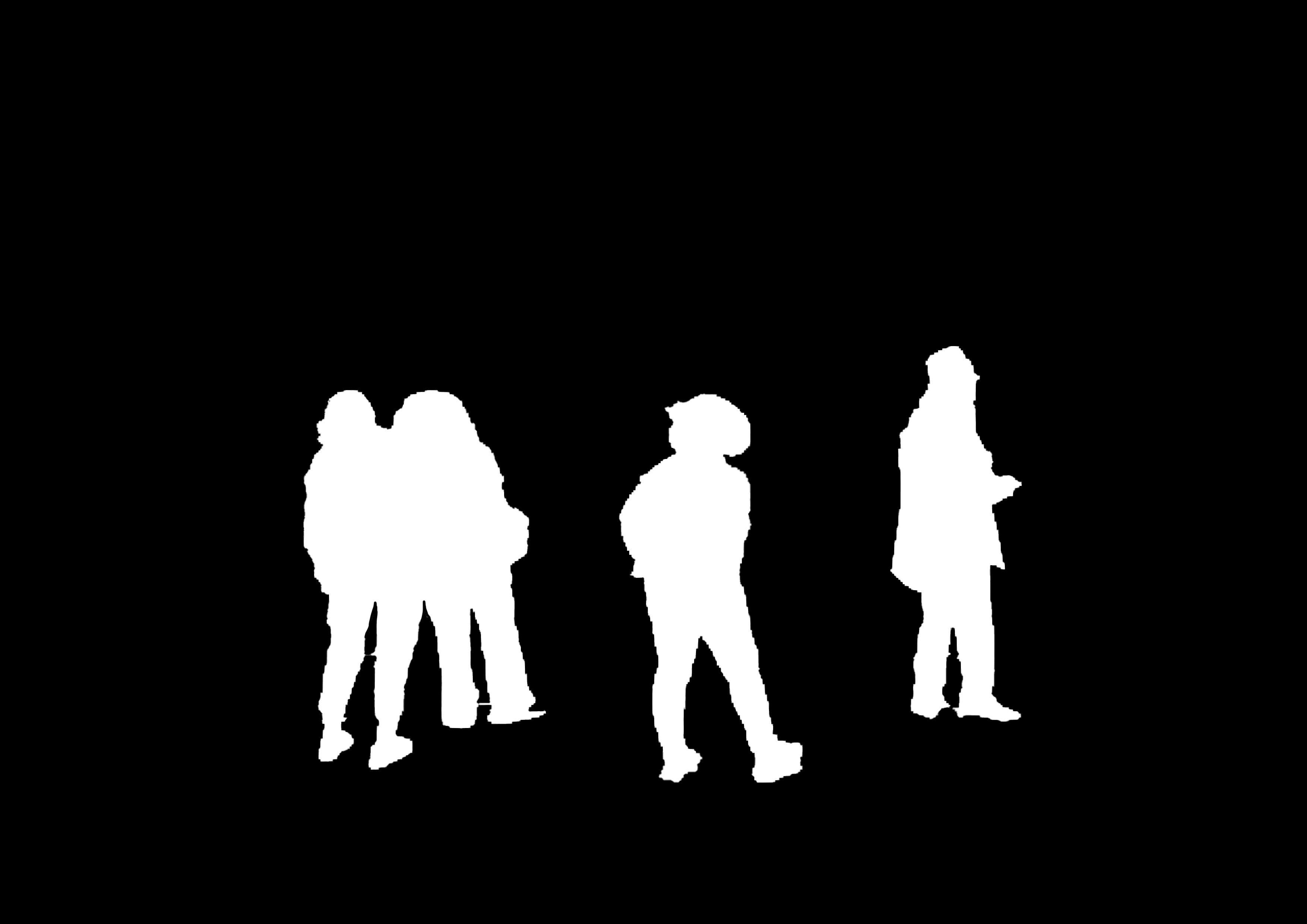

The goal is to have an output akin to an alpha mask (black for all un segmented parts of the image (the background), and white for all segmented parts). All other coloured masks and bounding boxes should be removed, hence why I am trying to alter the post-process. See below for an example:
This would then be processed further for different visual outputs, but I am having trouble even getting to the alpha mask stage.
