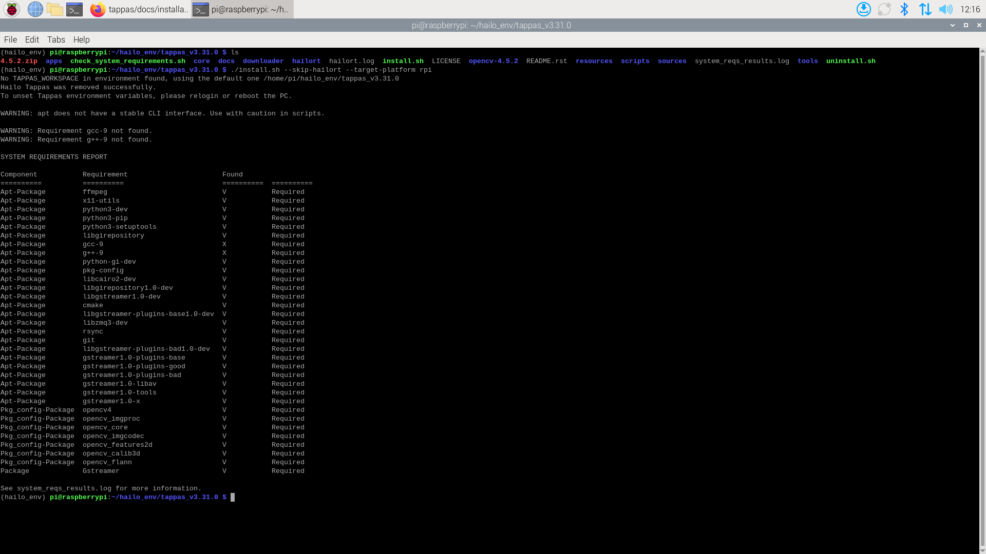

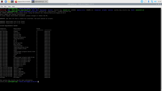

when follow official guide for manual TAPPAS installation i am getting error message about missing gcc9 and g++ 9 that i was unable to find solution for.

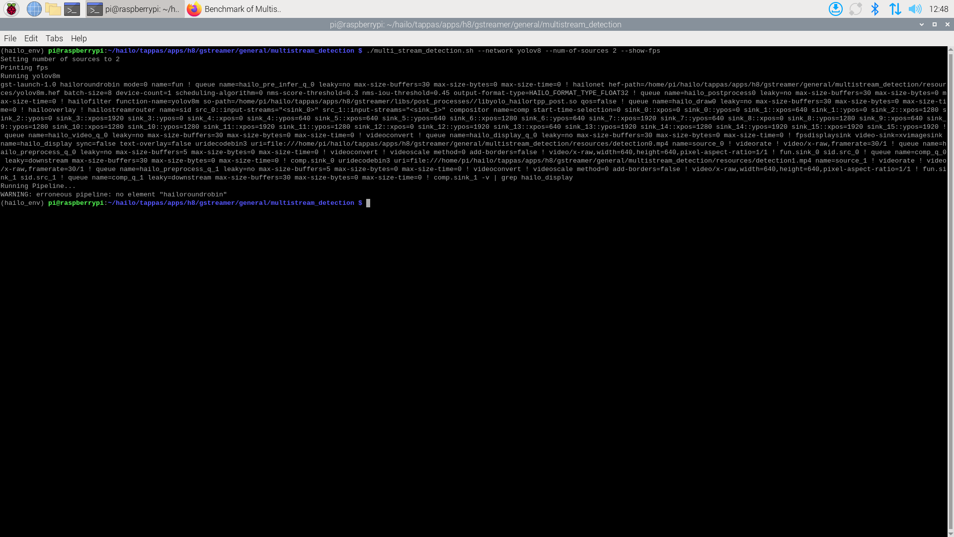

when i am following seeed benchmark example for multistream i successfully installed tappas but getting error about missing “hailoroundrobin”
