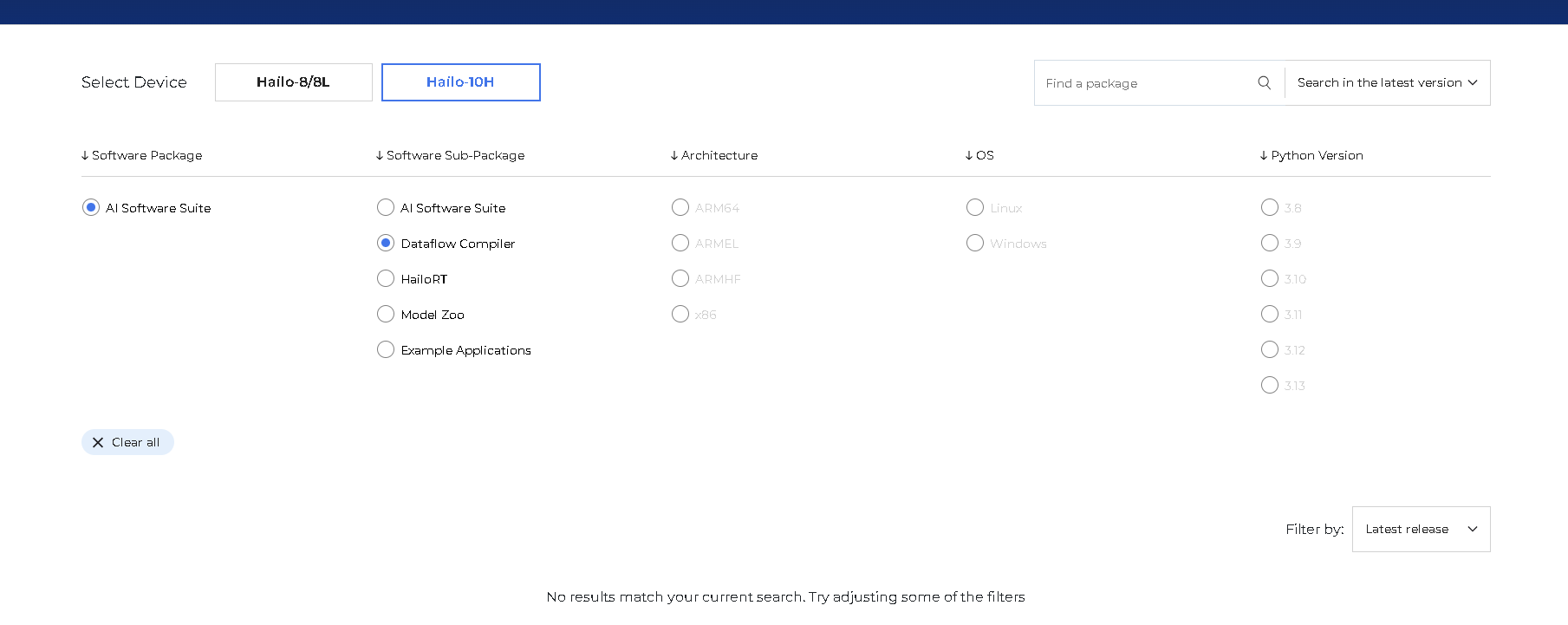

There is a different package of the Dataflow Compiler for Hailo-10H, please download it from the Developer Zone.
there is nopackage here. Can you give me the link of it?
