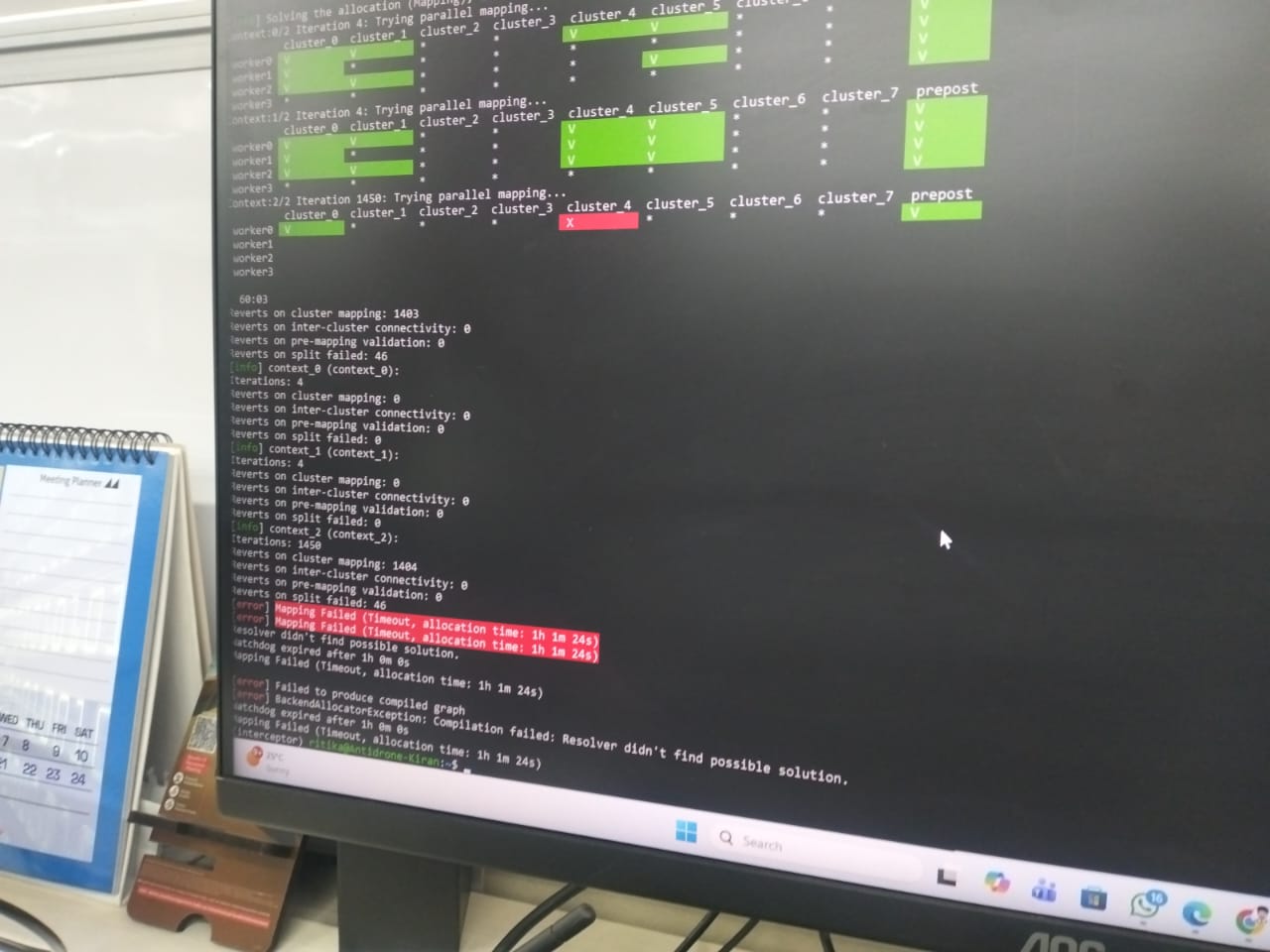

I am converting a .onnx file to .hef file. I am done converting the file into .har but when I am performing the last step to compile and get the .hef file i am getting the mapping failed error, i am using the images 640x640 size.
How to solve this error and what could be the possible methods. Or does anyone has different method to do this conversion?

I have actually tried both of the mentioned steps yet getting the same error. What can be the issue here?
@ritika_dawande Could you please share the full error log from those runs (hailo_sdk.core.log)?
