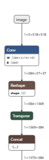

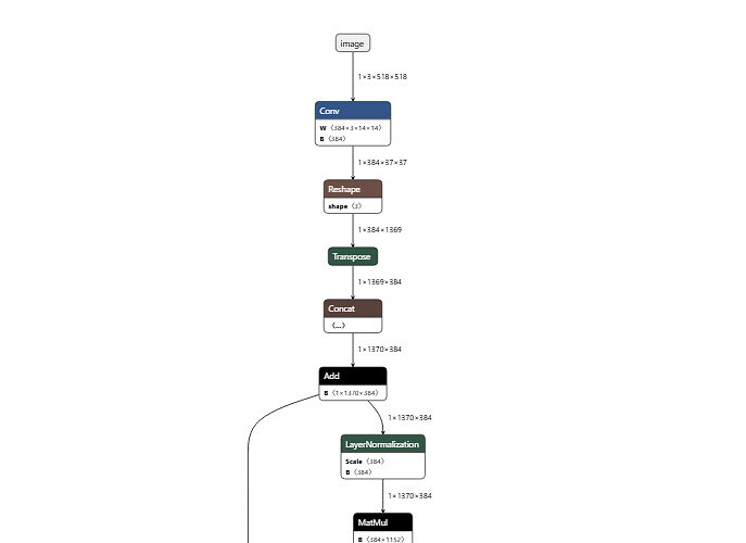

See the differences between ViT and DepthAnythingV2, it seems that the difference in input size in a part of Patch Embedding is related.
part of patch embedding in DepthAnythingV2 part of patch emebedding in ViT

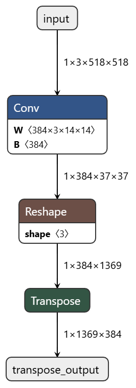

So I extracted a part of the Patch Embedding processes (Conv2D, Reshape, Transpose) and tested them with a small model.

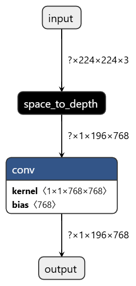

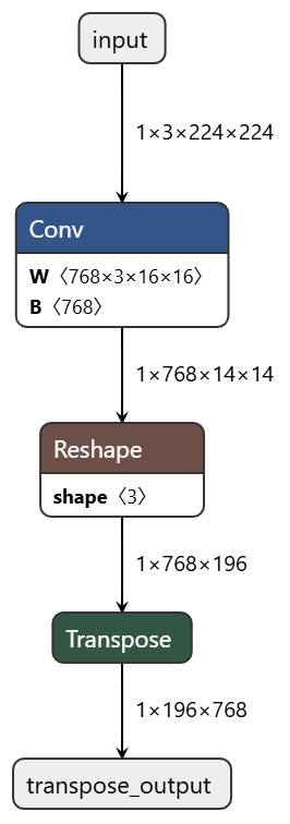

I ran to parse a model with 224x224 input (same as ViT), it was translated into space_to_depth + Conv2D, and the compilation was successful.

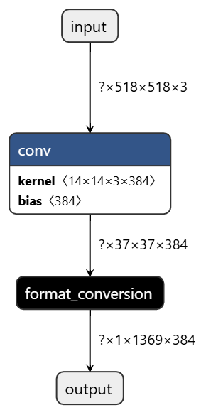

On the other hand, I ran to parse a model with 518x518 input (from DepthAnything V2), it was translated into Conv2D + format_conversion, and the compilation failed.

What is the difference? Is there any way to compile a model with 518x518 input somehow?
