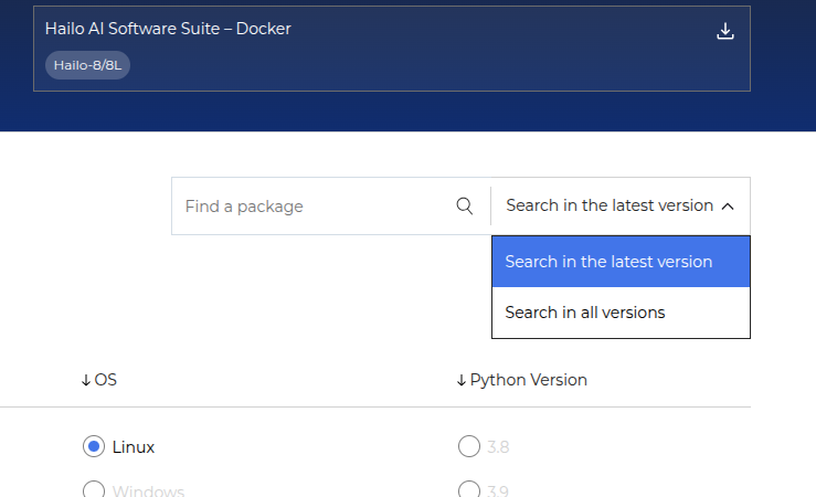

Hi @Jose_Fuertes,
Can you please try this?
Michael.

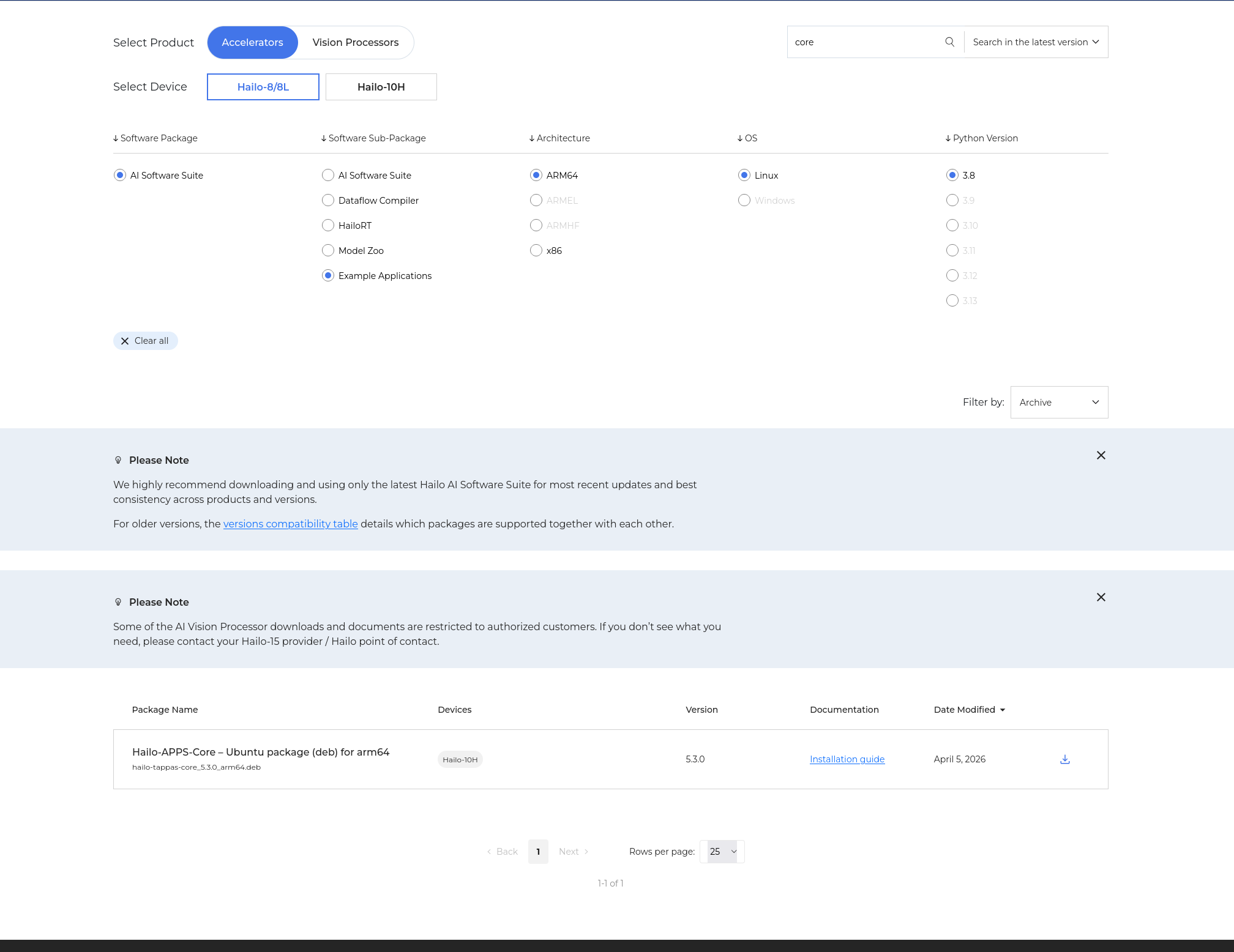

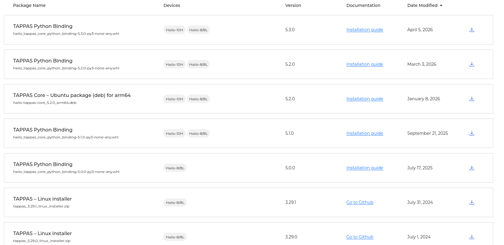

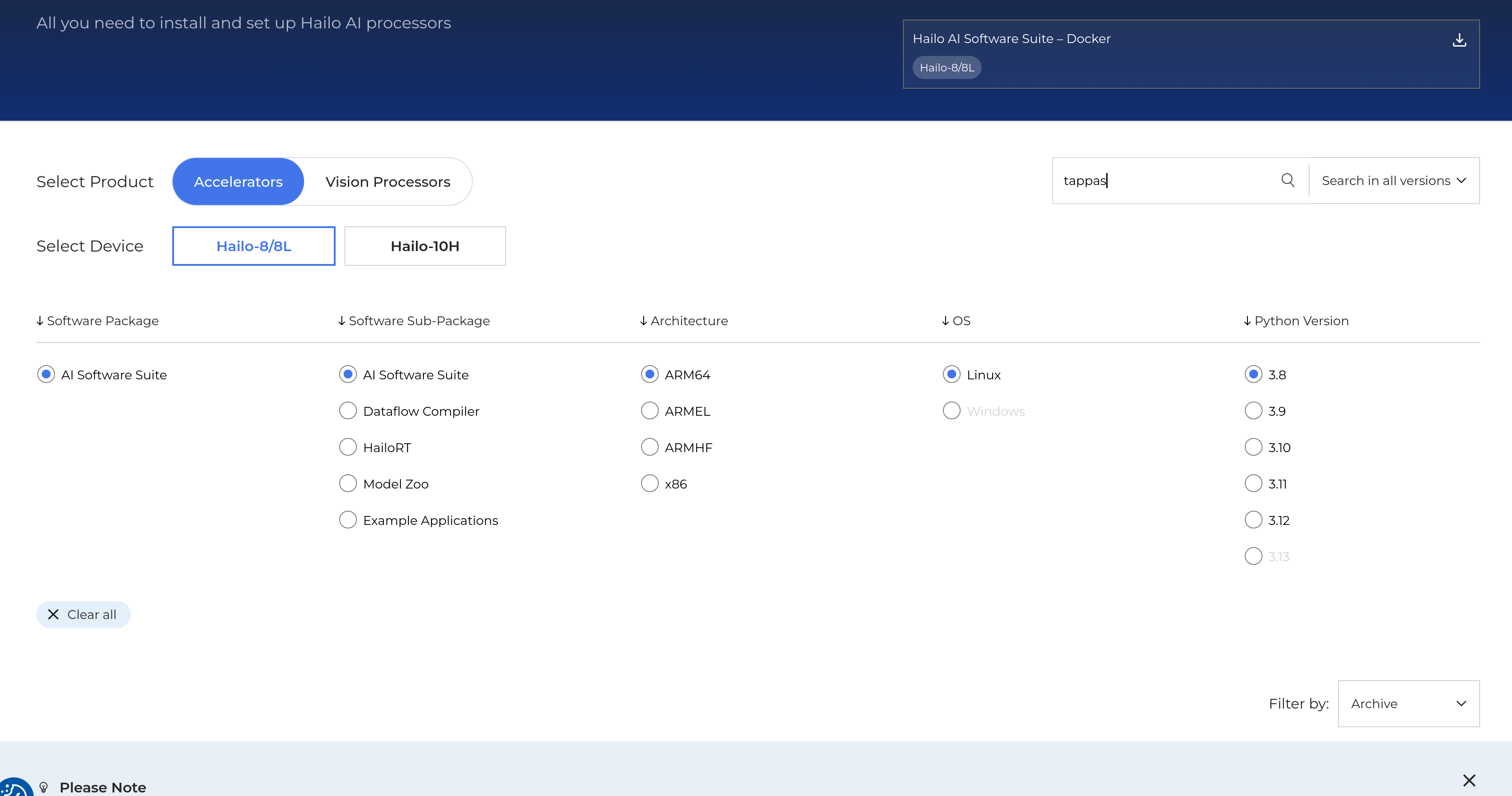

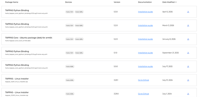

Hi @Michael
I have applied the filters detailed below, but the arm64 architecture version for the Raspberry Pi 5 (with Hailo-8 26 TOPS) is not appearing. While I found versions for Ubuntu, I cannot find TAPPAS Core v5.1.0 for Raspberry Pi.
I have also tried different filters by changing the Python versions and searched using both ‘tappas’ and ‘core’ as keywords, but I still cannot locate the required hailo-tappas-core_5.1.0 package for arm64.
Following your suggestions, I have checked using the filters you mentioned**, but I can confirm that TAPPAS Core version 5.1.0 is still not visible for the ARM64 architecture (Raspberry Pi).
When searching, I only see versions 5.2.0 and 5.3.0 (the latter being compatible only with Hailo-10 according to the official page). Although the Python binding v5.1.0 is available, the TAPPAS Core is not. I have also tried to compile directly from hailo_core_apps/releases without success.
