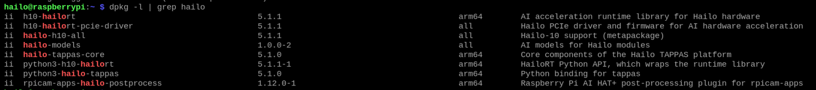

Installed Hailo Packages
hailo-gen-ai-model-zoo        5.3.0 (arm64)
h10-hailort                   5.2.0-1 (arm64) [installed per Hailo-10H requirements]
hailo-tappas-core            5.2.0 (arm64)
python3-h10-hailort          5.2.0-1 (arm64)
rpicam-apps-hailo-postprocess 1.11.1-1 (arm64)
hailo-apps Installation
hailo-apps                    26.3.0
hailort (Python binding)      5.2.0
hailo-tappas-core (Python)    5.1.0

Unfortunately, I still can’t get any further. I uninstalled everything, and installed everything again according to your script. Installation Verification
📁 Virtual environment: ✅ OK
🐍 hailo_apps package: ✅ OK
📦 HailoRT Python binding: ✅ OK
📦 TAPPAS Core Python binding: ✅ OK
🏗️ Hailo Architecture: hailo10h
📦 Model Zoo Version: v5.1.0
📁 Resources symlink: ✅ OK
Found 22 model files (.hef)
📄 Environment file: ✅ OK (/usr/local/hailo/resources/.env)
🔨 C++ postprocess libs: ✅ 15 libraries

Hi @Achim_Haber,
I want to understand your setup, because Hailo Gen AI Zoo is not part of hailo-all APT list of packages.
This is the current list:
