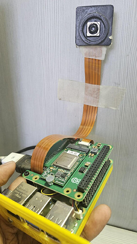

Hardware Used:
  1. Raspberry Pi 5
  2. Hailo AI Accelerator (Hailo-8 / Hailo-8L)
  3. Raspberry Pi Camera Module
  4. GPIO-based alert output (LED / buzzer)

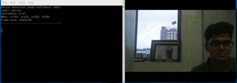

The application runs a real-time detection pipeline using Hailo’s basic_pipelines/detection.py.
Detection Flow:

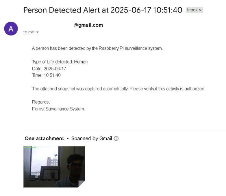

  • Live camera frames are processed on-device using the Hailo accelerator
  • When a person is detected with confidence greater than 96%, the system waits for 2 seconds to confirm persistence
  • A snapshot is captured with bounding box and timestamp
  • The snapshot is automatically sent via email as an alert
  • A 10-minute cooldown is applied to avoid repeated alerts
  • A GPIO pin is triggered to support physical alerts
  • All snapshots are stored locally for later review
