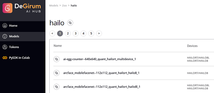

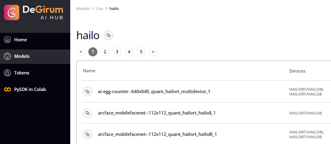

Hi shashi
“DeGirum model zoo” is not provide “arcface_r50”, now it noly support “arcface_mobilefacenet–112x112_quant_hailort_hailo8l_1” , Is there any chance to provide “arcface_r50”. i’m try to replace it, but the result is different to the “WebFace600K_pfc_model.onnx”
Hi @kimi_Jhong
We will add the model and keep you posted.
