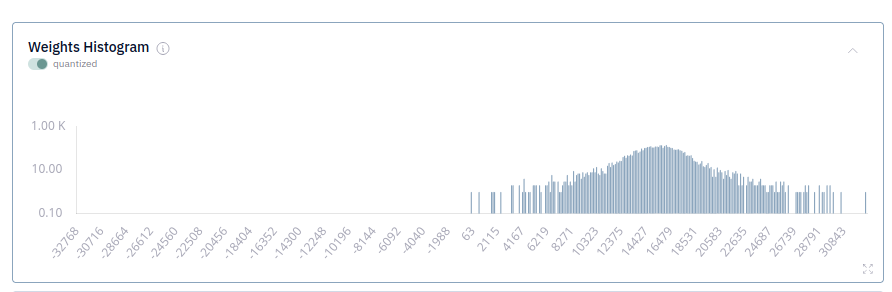

I’m working on a project where I need to quantize a neural network to 16-bit. My workflow itself works well, but I’m running into an issue: when I use precision mode to quantize the model to 16-bit, the weights and activations end up in the range 0 to 32,000 (even though I expect them to be in –32,000 to 32,000).
When I use the default INT8 optimization, everything is correctly represented in the range –128 to 127.
Can someone explain why this happens or how I can fix it? Does this have something to do with the zero-point?

Hey @Lars_Hofmann ,
Good question! What you’re seeing—quantized values in the 0 to ~32,000 range when using 16-bit—is expected with Hailo’s quantization. It’s not an issue with the 16-bit mode itself.
Hailo uses unsigned integers for all quantized values. The actual (real) values are recovered using a scale and zero-point (qp_scale, qp_zp). So even though the stored ints are non-negative, the real values can still be negative or symmetric around zero.
Key points:
  • Seeing only positive values in histograms is expected.
  • The real dynamic range depends on the scale and zero-point.
  • You can constrain real output ranges using force_range_out, e.g.:
quantization_param(conv1, force_range_out=[-1.0, 1.0])
This behavior is part of how Hailo’s quantization works—not a bug.

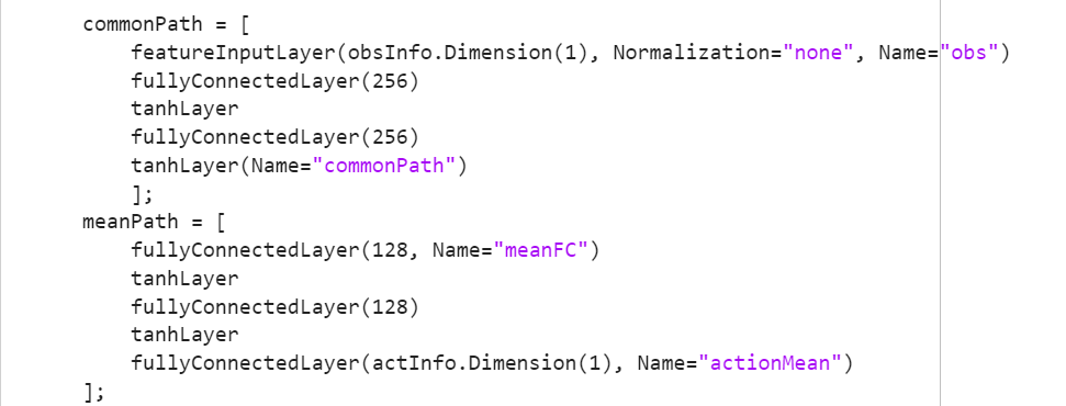

Below is the architecture of the network:

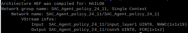

Hey @omria,
following the infos you asked for.
hailortcli parse-hef SAC_Agent_8Bit.hef gives:
Quant-Info are:
Input stream size: 1
Input frame size: 24
Input quantization info:
Scale: 0.00976785
Zero point: 114
Output frame size: 8
Output quantization info:
Scale: 0.0326291
Zero point: 130
The functions, which are relevant for inference are the following, at the moment we are using raw streams:

Is it okay for us to use raw streams in our case? If not, how do we need to change it so that it works with vstreams?
Thanks for your help
Lars
