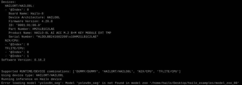

Hi @shashi im having a problem over here on infering yolov8n_seg model
this is my model zoo files and im sure im following you step but not sure why this causes
Blockquote

and the model i downloaded from the public model repo
https://github.com/hailo-ai/hailo_model_zoo/blob/master/docs/public_models/HAILO8L/HAILO8L_instance_segmentation.rst
okkay i dont know why after add checksum the infering works fine. Anyways thanks for the sdk support for hailo
Hi @SAN
Glad to see it working for you. The checksum is a field we use in our model zoos to track if the model got updated. While it makes sense only for AI hub model zoos, in our design it is a required parameter.
