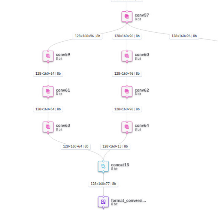

I am trying to compile custom trained YOLOv8m with P2 head model to hef file. But even though i have made changes in .yaml file and given nodes name according to my model :

when I am doing :
hailomz compile --yaml yolov8m.yaml --ckpt yolo8m.onnx --hw-arch hailo8 --calib-path ThermalImages --classes 13
or trying to parse the
hailomz parse --yaml yolov8m.yaml --ckpt yolo8m.onnx --hw-arch hailo8
the generated .har file should have output layer 1, output layer 2 and so on. But It is not able to generate that instead it is being concatenated.
Due to which i am facing error in further compilation.
Hey @Suraj_Upadhyay,
You’re getting one big concatenated output instead of separate detection layers because the parser is diving too deep into your YOLOv8 model - it’s going past your intended stopping point and picking up Ultralytics’ built-in postprocessing layers (things like Concat, Sigmoid, DFL, etc.).
Could you share your alls and yaml files for this compilation?

@omria I got the solution for above. But i wanted to know is there a way to reduce context of heavy models like yolov8m or 8l which has 3 and 4 contexts.
i tried reducing parameters and number of layers but still same result.
Hey @Suraj_Upadhyay ,
To reduce the number of contexts for large models on Hailo devices, the most effective approaches are:
  • Increasing the compression level
  • Enabling performance mode
  • Reducing input resolution
Keep in mind that for very large models, hardware limitations may prevent them from fitting into a single context, even with these optimizations applied.
