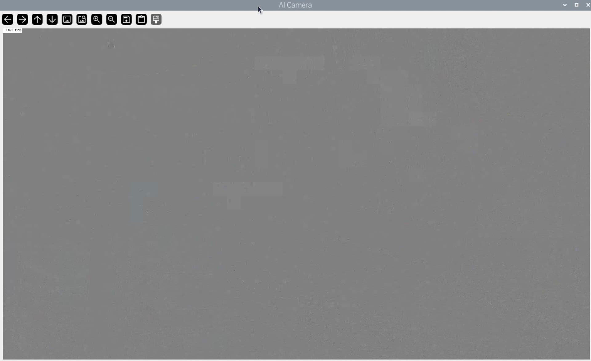

Hi @omria , thank you very much for your response.
Using your recommendations, I wrote this code, but this time managing only one camera.
I used the threading library to handle capture and inference in concurrent processes. This was the best solution I found so far, since according to my project’s constraints, I can only use one core of the Raspberry Pi’s CPU — the rest is reserved for other tasks.
After testing, it turns out that capture and inference now run at almost the same frame rate. In other words, the significant delays that occurred when the process was sequential are no longer present.
On the other hand, I implemented Hailo’s asynchronous inference, but since I’m doing real-time detection, I need the results immediately after calling hailo.run_async, so the true benefits of asynchronous execution are not being leveraged. So, my question is: in my case, does it make sense to use Hailo async?
How could I implement it in my current code?
Thanks again — I look forward to your response.
