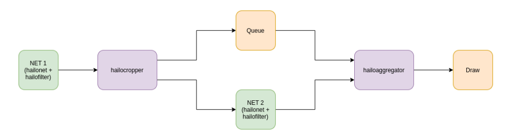

Overview
HailoCropper is an element providing cropping functionality. It has 1 sink and 2 sources. HailoCropper receives a frame on its sink pad, then invokes it’s prepare_crops method that returns the vector of crop regions of interest (crop_roi), For each crop_roi it creates a cropped image (representing it’s x, y, width, height in the full frame). The cropped images are then sent to the second src. From the first src we push the original frame that the detections were cropped from.
HailoAggregator is an element designed for applications with cascading networks or cropping functionality, meaning doing one task based on a previous task. A complement to the HailoCropper, the two elements work together to form versatile apps. It has 2 sink pads and 1 source: the first sinkpad receives the original frame from an upstream hailocropper, while the other receives cropped buffers from that hailocropper. The HailoAggregator waits for all crops of a given orignal frame to arrive, then sends the original buffer with the combined metadata of all collected crops. HailoAggregator also performs a ‘flattening’ functionality on the detection metadata when receiving each frame, detections are taken from the cropped frame, copied to the main frame and re-scaled/moved to their corresponding location in the main frame (x,y,width,height).
Example
following example will demonstrate the use of the hailocropper and hailoaggregator in a Gstreamer pipeline which overlay a detection bbox over the original frame and send the output to display.

pipeline breakdown
- Specifies the location of the video used, then decodes and converts to the required format.

- Defines the hailocropper process cropping algorithm
hailocropper so-path=/local/workspace/tappas/apps/gstreamer/libs/post_processes//cropping_algorithms/libwhole_buffer.so \ use-letterbox=false function-name=create_crops internal-offset=true name=person_detect_cropper \
- Sets the aggregator name
hailoaggregator name=person_detect_agg
- Defines the first cropper src which passes the original frame and connects to the aggregator
person_detect_cropper.src_0 ! \ queue name=person_detect_q leaky=no max-size-buffers=30 max-size-bytes=0 max-size-time=0 ! \ person_detect_agg.sink_0
- Defines the cropper second src, and sets the frames into a queue
person_detect_cropper.src_1 ! \ queue name=hailo_person_detect_q leaky=no max-size-buffers=30 max-size-bytes=0 max-size-time=0 ! \
