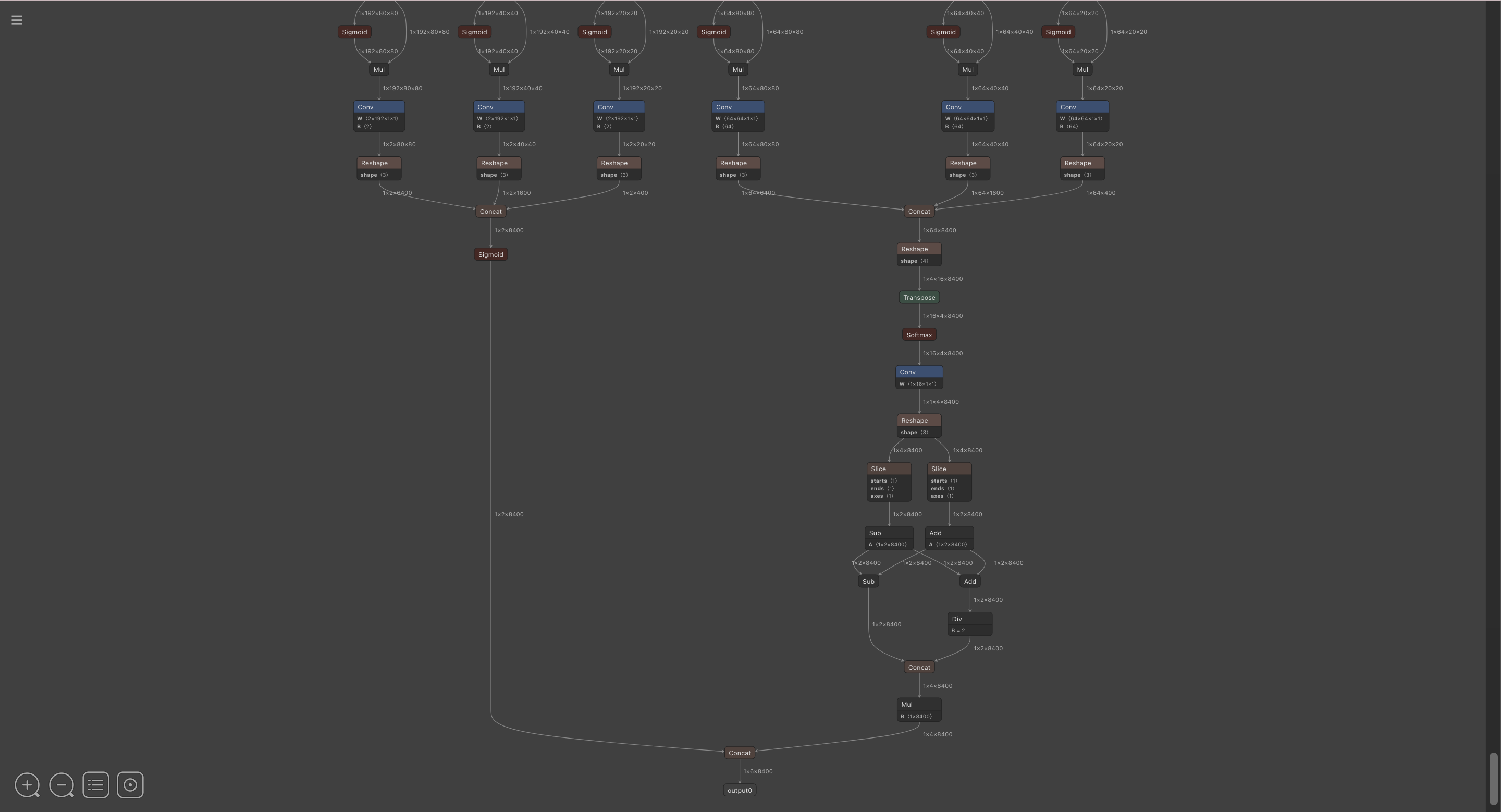

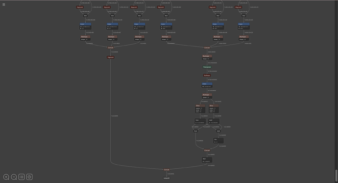

However, since the auto-parser didn’t detect the standard YOLOv8 NMS structure (it usually prints “NMS structure of yolov8 was detected” - yours didn’t), it’s possible your ONNX model has non-standard layer names. To verify, you could open your .onnx file in https://netron.app and check whether those 6 conv layer names actually exist in your model graph. If the layer names are different, you’ll need to find the equivalent conv layers right before the detection head’s concat/decode operations and use those instead.
Also worth checking - how did you export from .pt to .onnx? The standard Ultralytics export (yolo export model=best.pt format=onnx opset=11 imgsz=640) should produce a graph structure the parser recognizes. If the model was exported through Roboflow or a different tool, the graph structure might differ.
