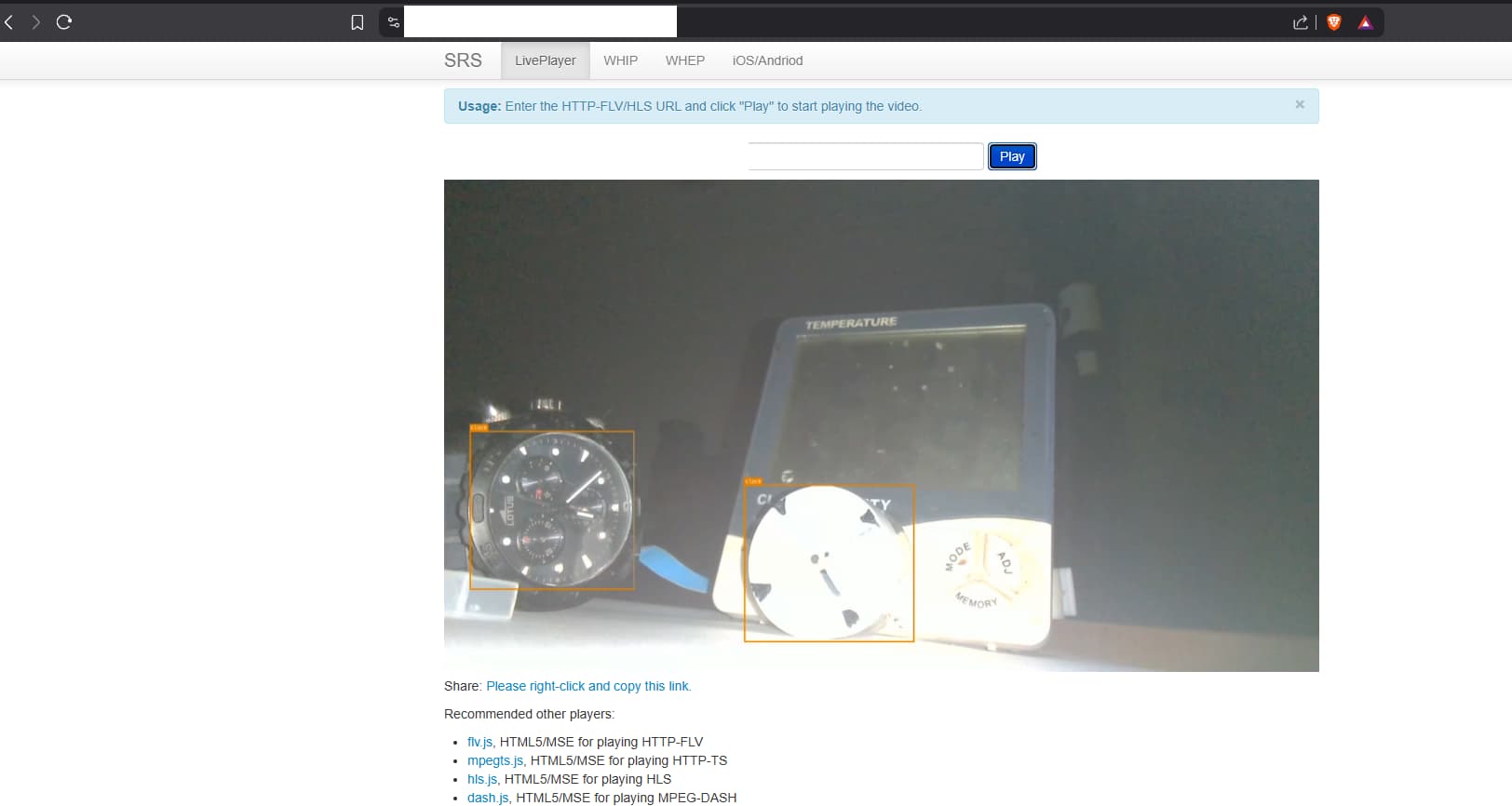

The only code I was able to output to RTMP is my original hailo-platform only based script… that script is using almost the same ffmpeg command that your VideoStreamer degirum_tools/degirum_tools/video_support.py at main · DeGirum/degirum_tools · GitHub
I was able to make it work!
I had to change a few things on the orginal degirum_tools/video_support.py to enable debugging
Once I had debug enabled was more easy.
With this simple mod in video_support.py make output RTMP streaming enabled with VideoStreamer and VideoStreamerGizmo

Nice, thank you! You nailed it!
Now a tag with same name and the track_id number is uder the actual label
Something I noticed is that each tie the script runs, the bbox color is different even for the same class
Do you know if it is possible to use this track_id to do something else?

Thank you very much!!!
The detector example is exactly what I was looking for… :partying_face:
Do you know if there is some way to customize the bbox? like selecting the color (I would prefer red, more “alarm” style :wink: ) or maybe changing the text on the labels?
I noticed that the text on the bbox label and the text on track_id label is the same text:
| Clock  |
|Clock:  1       |
|    X  º  III   |
|       VI       |
and it seems a liitle bit weird having two times the same text, maybe if both has to be shown the track id label would be better to simpy have ‘ID: 1’ as label instead ‘Clock: 1’
Maybe the color problem had something to do with the model, I was testing all the yolovX-coco models to do benchmark, maybe one of them was changing the color
found about the color in the docs.
annotation_color : Customize overlay appearance
Sorry I was very exited and answered before reading the documents
