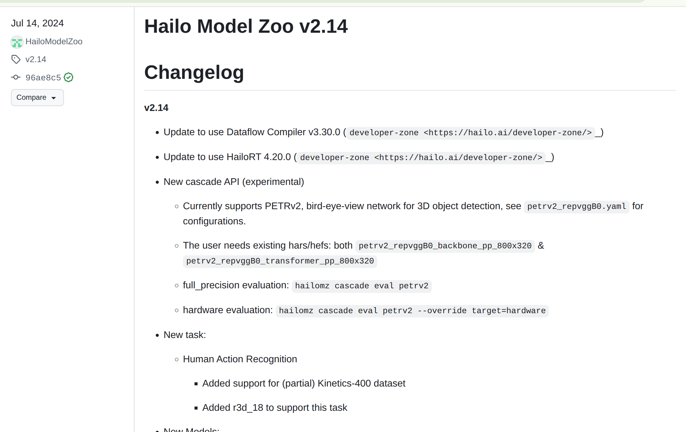

Can not use hailomz to compile the model
I use hailort 4.20, so I used hailo_model_zoo v2.14

I made a mistake, install the wrong version of DFC.
Now I install like below:
(.hailo_convert) jiahao@jiahao-pc:~/hat_detection$ hailomz --version
Hailo Model Zoo v2.14.0
(.hailo_convert) jiahao@jiahao-pc:~/hat_detection$ hailo --version
[info] Current Time: 17:07:12, 10/21/25
[info] CPU: Architecture: x86_64, Model: 11th Gen Intel(R) Core™ i7-11700F @ 2.50GHz, Number Of Cores: 16, Utilization: 1.5%
[info] Memory: Total: 31GB, Available: 20GB
[info] System info: OS: Linux, Kernel: 6.8.0-85-generic
[info] Hailo DFC Version: 3.30.0
[info] Running hailo --version
Hailo Dataflow Compiler v3.30.0
But it still not work:
